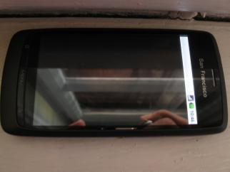

Guest flopyro Posted November 14, 2010 Report Posted November 14, 2010 ok .. i have tryed this-> http://android.modaco.com/content-page/319...etting/page/60/ i have done this: Bump! This is a valid question that I'd like the answer to. EDIT: Nevermind, copied the gralloc.msm7k lib from pauls ROM and it fixed the problem. didn't worked for me....:rolleyes: (stock rom) i have activated HW acceleration...and i saw the artifacts, when i copyed the "gralloc.msm7k " file to system\lib\hw the phone became almoust unusable, it was so sluggish and i don't want to flash it.... i will have to use it widouth HW acceleration i tryed to put HW acceleration to "0" and now i can;t see anything on the device, i have tryed to pun an original gralloc.msm7k back to the phone D:\andro\andro\tools>adb push gralloc.msm7k.so /system/lib/hw/gralloc.msm7k.so 598 KB/s (17764 bytes in 0.029s) D:\andro\andro\tools>adb shell chmod 755 /system/lib/hw/gralloc.msm7k.so Unable to chmod /system/lib/hw/gralloc.msm7k.so: Operation not permitted nothing ! i even did a factory reset and still nothing.. but i can see the lockscreen, i dont understand this phone !!!! is there a way to HARD reset this phone ? most of you will say to just flash the phone, i;m scared ! just bought the phone from ebay, and i;m from Romania !!! what should i doo ?
Guest MDCFan Posted November 14, 2010 Report Posted November 14, 2010 (edited) Could you just flash some ROM from recovery? Edited November 14, 2010 by MDCFan
Guest MDCFan Posted November 14, 2010 Report Posted November 14, 2010 i'm scared !!! donno why ... Just try flashing another ROM.
Guest The-One Posted November 14, 2010 Report Posted November 14, 2010 Did you mount the system as read and write?
Guest flopyro Posted November 14, 2010 Report Posted November 14, 2010 yes, but i did a factory reset.... ok .. i will try to flash it :-s
Guest rayraven Posted November 14, 2010 Report Posted November 14, 2010 How did you get into the settings screen? Looks to me maybe there's no default home screen set? Or maybe the one you set has force closed?
Guest flopyro Posted November 14, 2010 Report Posted November 14, 2010 (edited) i tryed this: ->http://android.modaco.com/content/zte-blade-blade-modaco-com/319565/07-oct-2-5-0-9-r2-clockworkmod-recovery/ to install "r2: ClockworkMod Recovery" and when i write "fastboot-windows flash recovery recovery-clockwork-2.5.0.9-modaco-r2-blade.img" it tells me: <waiting for device> i have the ZTE drivers installed, it's that important ? should i uninstall touse ? edit: i vent to the settings screen beacuse i knew the position the "icon" or "shortcut" on the screen one you press "menu" edit2: android usb drivers: search with google : android_usb_windows.zip edit 3: taraaaaaaaaa !!!! Edited November 14, 2010 by flopyro
