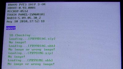

If I start in HBOOT (I don't know if there is any relation), I get a very fast message telling:
SD Checking ...
Loading...[PB99DIAG.zip]
No image!
Loading...[PB99DIAG.nbh]
No image or wrong image!
Loading...[PB99IMG.zip]
No image!
Loading...[PB99IMG.nbh]
I would appreciate any help to get out of this situation.

Guest Thomas1107
SD Checking ...
No image!
No image!
Thats normal..
But id try to run a ruu for your phone and start from scratch again.:;)

I am getting the same above messages in the bootloader. What do I do? I don't understand the above poster's comment "try to run a ruu for your phone and start from scratch again".
