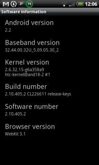

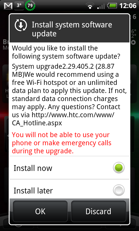

I have an unbranded desire (GSM), rooted with the latest unrevoked, and an official ROM.Today I have received a new update OTA… something with Android Market in size of 28.87 MB. I’ve tried to install but I have not succeeded. For more info about my phone see the attached pictures.
Now the details: I saw that the update was not working , so I decided to “force “ the install process using the install update.zip from clockwork mode (2.5.0.7) and toggle signature option (it was a message about some signature error). Everything looked fine, all the process and then a message tells me to restart. Since then a loop started: white screen with green letters for HTC logo and after that a restart. And again, and again…
