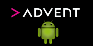

Guest JordanT92 Posted December 17, 2010 Report Posted December 17, 2010 (edited) Anybody care to share some bootscreens we can replace the ADVENT logo with? The screen resolution is 1024x600. How to replace your bootlogo: Create and save your bootscreen as a PNG (if it is smaller than 1024x600, your bootscreen will be centered, transparency will result in the ANDROID boot glare effect) 1. Connect your Vega to your PC's usb. 2. Turn USB Debugging on in the Applications menu. 3. In command prompt / terminal, browse to the directory containing adb-windows.exe (included in Paul's MCR mod), type: adb-windows pull /system/framework/framework-res.apk /framework-res.apk This will grab framework-res.apk from your Vega and save it in the directory adb.exe is located. 4. Open framework-res.apk in WinRAR or similar and browse to /assets/images/ 5. Replace android-logo-mask.png with your bootscreen and save the apk in the same format, overwriting the original. 6. In your already open command prompt / terminal window type: adb-windows remount adb-windows shell rm /system/framework/framework-res.apk adb-windows push framework-res.apk /system/framework/ 7. Reboot your Vega. My current bootscreen: If you want to make your new framework-res.apk smaller, you could delete the following files from /res/drawable/: nvidia_wallpaper01.jpg nvidia_wallpaper02.jpg nvidia_wallpaper03.jpg nvidia_wallpaper04.jpg nvidia_wallpaper05.jpg nvidia_wallpaper06.jpg nvidia_wallpaper07.jpg nvidia_wallpaper_dual01.jpg nvidia_wallpaper_dual02.jpg nvidia_wallpaper_dual03.jpg nvidia_wallpaper_dual04.jpg nvidia_wallpaper_dual05.jpg nvidia_wallpaper_dual06.jpg nvidia_wallpaper_dual07.jpg As far as I can tell, it doesn't mess with the system at all. Edited December 17, 2010 by JordanT92

Guest JordanT92 Posted December 17, 2010 Report Posted December 17, 2010 Oh yeh, be careful to ensure you have enough space in the NAND, because if you don't, it won't copy, the original framework-res.apk will be screwed, ADB will stop and no programs will open, then you'll get a black screen when rebooting and will have to flash a stock rom. But you shouldn't really have many problems..

Guest AndiTails Posted December 18, 2010 Report Posted December 18, 2010 (edited) I removed the nVidia files, and removed the framework-res.apk from my Vega, but when pushing the file back, I got "insufficient space". If anyone else gets this, here's my tip. I had a poke around via adb shell and decided I wouldn't need the ringtones on the device, so: At the Windows command prompt type adb remount adb shell then at the # prompt, type: cd /system/media/ringtones rm *.ogg exit Now try to push framework-res.apk back on to the Vega as the instructions above. You should have space now and it goes on fine :) P.S. That looks a LOT nicer than > Advent Edited December 18, 2010 by AndiTails
Guest remlap Posted December 18, 2010 Report Posted December 18, 2010 Could anyone upload the default bootscreen image file please?
Guest boffboff Posted December 18, 2010 Report Posted December 18, 2010 adb-windows pull /system/framework/framework-res.apk /framework-res.apk Just to let you know for some reason it wouldn't pull framework-res.apk unless I omitted the target location. Weird! It would say xx kb transferred but nothing would copy over. I even did a search of my hdd for it! But adb pull /system/framework/framework-res.apk worked for me (or adb-windows if you're using that) and copied it to the directory I was running adb from. I've attached the default bootscreen for those who want to play.
Guest r8zer Posted December 18, 2010 Report Posted December 18, 2010 (edited) I removed the nVidia files, and removed the framework-res.apk from my Vega, but when pushing the file back, I got "insufficient space". If anyone else gets this, here's my tip. I had a poke around via adb shell and decided I wouldn't need the ringtones on the device, so: At the Windows command prompt type adb remount adb shell then at the # prompt, type: cd /media/ringtones rm *.ogg exit should be cd /system/media/audio/ringtones just so any one else wishes to try. Also looks so much better then having advent boot on screen. Edited December 18, 2010 by r8zer

Guest AndiTails Posted December 18, 2010 Report Posted December 18, 2010 should be cd /system/media/audio/ringtones just so any one else wishes to try. Also looks so much better then having advent boot on screen. Ah yes, of course, good spot. Fixed.
