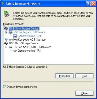

Guest trevor432990 Posted December 30, 2010 Report Posted December 30, 2010 Have noticed since installing the new USB Slave/Host mod I can no longer use Windows Explorer on my PC to see the content of my Vega even with cable plugged in and USB debugging running etc. Can anyone else confirm this is what they are finding as well and any idea if this will this cause a problem come the next update? For info the attached image shows what I see when I go to 'eject' the Vega connection :-

Guest trevor432990 Posted December 30, 2010 Report Posted December 30, 2010 (edited) Are you still in host mode? because that will stop you from being able to use adb/mount usb storage. Nope definitely switched to Slave using Pauls new mod. Haven't seen the 'Android Composite ADB interface' displayed before this mod though Edited December 30, 2010 by trevor432990

Guest trevor432990 Posted December 30, 2010 Report Posted December 30, 2010 Problem solved. Apologies to Pyro & Higgsy who were asking the right questions but I was not looking in the correct place. I was missing steps 3 - 5 of the process you should follow when connecting the USB cable to a PC namely:- Settings > Application Settings > Development > USB Debugging tickConnect USB cable itselfPull down notification window from notification bar Click on USB connectionClick on 'Turn on USB storage' Once I'd followed the correct sequence of actions Windows could then access the Vega as if it was a removable disk again. Thanks guys :(
