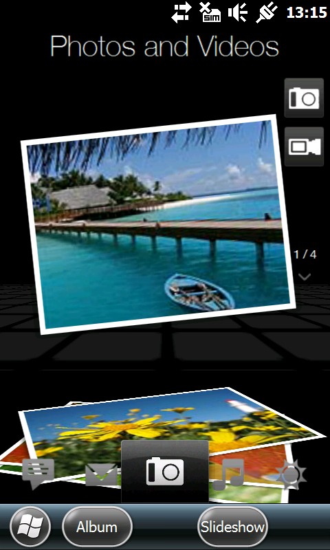

Guest Thunder141 Posted January 7, 2011 Report Posted January 7, 2011 (edited) Is there any interest in an old touchflo 1.3 rom for b7610, cause I made it for myself? Its based on the original cabs and fixes for the i8000. If so, I will share it. - Credits to: GinKage, Chainfire, NuShrike for the initial i8000 development all people helping to make it work - Some Details:based on my current ultra lite wm 6.5.3.9 build 21680 romTouch FLO 3D (Manila 1.3 adapted from I8000 thread)all samsung apps removed, except camera, clock, calendar, comm managerremoved sys packages: autoupdate, bronze, chome, bth_hid, enterprise, entertainment, ipsecvpn, internetsharing, lockscreen (default wm 6 lockscreen is enabled), office, one note, sample music, skybox, skymarket, sqlcemobile, themes, welcome center, windows live, wmmoney, widgetsremoved wm playerUC_NET includedPagepool is 10 MBsome registry tweaks not mentioned in detailOld WM 6.1 GPS driverincluded fixes: picture tab (working, thx to daskalos), comm manager, alarm clock and calendar redirected to samsung app (thx to tom131274), sensitive Display Fix (thx to tom131274)music tab working, kept wmplayer codecs in rom, voiladata memory: 272 mbprogram memory: about 70 mbsensivity on some screens like htc comm manager is poor (you have to press the wished item for an quarter of a second to take your choice)no landscape support so farwi-fi toggle will not work instantly. you have to change registry HKLM\Software\HTC\CommManager\WLAN\DeviceName. Replace TNETW12511 to your wifi adapter name. Look at HKLM\Software\Drivers\WLAN for your name (thx to Daskalos for finding this issue)- Downloads [*]WWE Testversion Edited January 19, 2011 by Thunder141

Guest Thunder141 Posted January 7, 2011 Report Posted January 7, 2011 (edited) Looks quite interesting, Thunder! Count me in! Can you tell us some more about it? Like RAM consumption or LandscapeMode? GreeZ! Freezy1982 As you can see in screenshot, program memory is about 65 MB but with activesync and mymobiler (for screenshots) started. Landscape-Mode i will check this, cause i recently made a fixed rom that I am about to install now. Edit: No Landscape and so far found no landscape fix like for sense Edited January 7, 2011 by Thunder141
