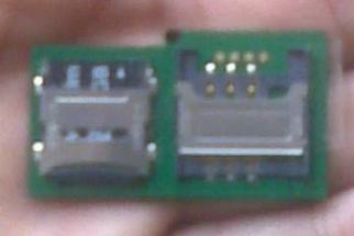

Guest costan1986 Posted February 1, 2011 Report Posted February 1, 2011 (edited) I guess he meant the secondary mainboard what hosts the SD card and SIM card. Just a suggestion, but have you tried cleaning and fixing the flex cable what connects this "card" to the motherboard? (under fixing I mean FIXING it into place, not repairing it ;) ). I don't think a simple drop would damage the mainboard so much that it loses contact, it must be a bit of a re-attaching or re-assembling problem. Yes, this one in the picture (sorry for poor quality ;)) Everything seems ok with connection...just one thing I noticed this morning while making the photo, in the part I marked with YELLOW ring, seems to have a SMT resistor missing, I can see one "grey" colored, another "black" and an empty space between two holes. Maybe it's gone lost on the drop Edited February 1, 2011 by costan1986
Guest Sborovm Posted February 1, 2011 Report Posted February 1, 2011 (edited) If someone will be so kind and tell you the number on the resistor (or measure the value if there isn't the number), it will be easy to fix it. But you have to find someone that could solder SMD parts. It had to be a good shot which ripped off the resistor. ;) Edited February 1, 2011 by Sborovm
Guest costan1986 Posted February 1, 2011 Report Posted February 1, 2011 (edited) If someone will be so kind and tell you the number on the resistor (or measure the value if there isn't the number), it will be easy to fix it. But you have to find someone that could solder SMD parts. It had to be a good shot which ripped off the resistor. ;) Yeah, it was a great crash with the floor :S back cover and battery flew away! My mistake on the picture! Resistors I was talking about are those on the YELLOW ring... Few minutes ago I noticed that one seems to be missing, and another one is floating...hope some friend could solder it! Edited February 1, 2011 by costan1986
Guest isambard Posted February 1, 2011 Report Posted February 1, 2011 Yes, this one in the picture (sorry for poor quality ;)) Everything seems ok with connection...just one thing I noticed this morning while making the photo, in the part I marked with YELLOW ring, seems to have a SMT resistor missing, I can see one "grey" colored, another "black" and an empty space between two holes. Maybe it's gone lost on the drop aha, this explains more. i thought you lost the metal piece over the sim holder. i'd be surprised if the drop knocked off an SMT component but you never know... i would have guessed it is more likely the connection between the daughterboard and the mainboard.
Guest costan1986 Posted February 3, 2011 Report Posted February 3, 2011 This morning I made the soldering on the floating resistor with my friend, he told to me that it seems to be a sort of fuse...so he just removed it and made a shunt. However, contacts that plug the card on the mainboard seems to be damaged, so we put some paper for making more pressure on it. Seems to work now, but anyway I'm still looking for the spare part to be sure that phone works without any problem. So, let me know if you see some damaged unit or spare parts for sale ;) thanks!
