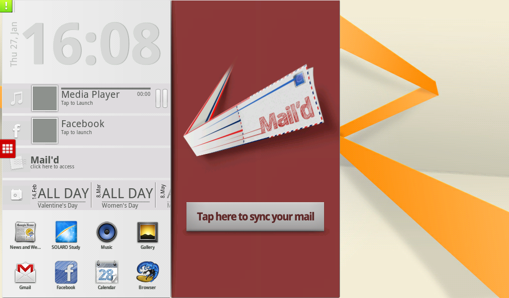

Guest Damian J Posted January 27, 2011 Report Posted January 27, 2011 (edited) Ok as promised here is my work on getting the adam rom booting and working on the vega. I must credit roebeet over at xda. I just took his work, fixed a few things, got it booting ETC. PLEASE NOTE THIS IS AN EARLY RELEASE AND IT WILL ONLY BOOT ONCE. SECOND BOOT WILL BOOTLOOP. NVFLASH TO FIX. I SUSPECT WHY AND IM WORKING ON IT. I MERELY PUT IT HERE FOR TESTING PURPOSES/FOR PEOPLE WHO WANT TO TEST EDEN. More info to follow as I am off to bed I just thought I should share asap. What I managed to fix: WiFi Sound What doesn't work Canvas force closes Camera (almost working) Power button BTW this is a clockwork package. Clear cache and data. ENJOY! EDEN for VEGA Edited January 27, 2011 by Damian J

Guest WaPeR Posted January 27, 2011 Report Posted January 27, 2011 (edited) Do you feel any disadvantage of having 512mb instead of 1gb? EDIT: Thanks for the pics Edited January 27, 2011 by WaPeR

Guest wobblydoggy Posted January 27, 2011 Report Posted January 27, 2011 (edited) Many thanks for this, did not want to install cwm but might give it a try to see this running. This is not my rom it's Damian J's who got it off roebeet on xda what i did: copied the zipped eden rom posted above to my sd put clockwork mod flash utility (located in pauls clockwork mod sticky) in C:\ANDROID\sdk\tools where my adb.exe is located and then connected vega to adb by using usb debugging opened cmd: adb push recovery.img /data/local/ adb push flash_image /data/local/ adb shell chmod 4755 /data/local/flash_image adb shell /data/local/flash_image recovery /data/local/recovery.img[/codebox] opened recovery which was already pre-installed on r6 and it booted into clockwork mod recovery made a nandroid backup cleared data and cleared cache clicked Installed from zip let it install, then reboot and voila When you have finished toying just reinstall 1.08 by putting it back into APX mode (back button 2sec, powerbutton 2sec, back button) and r6 then repeat the first process of cmd and go back into recovery to restore your backup and your vega will be just how you left it Edited January 29, 2011 by wobblydoggy
Guest shutdown Posted January 27, 2011 Report Posted January 27, 2011 it does look pretty, has to be said
Guest wobblydoggy Posted January 27, 2011 Report Posted January 27, 2011 it does look pretty, has to be said Most of the Apps are downloadable no no need to flash the full rom till its useable Sniffer,keyboard,calendar and mailed are all work on vega

Guest shutdown Posted January 28, 2011 Report Posted January 28, 2011 i like all the apps. keyboard is a bit odd to get used to but will keep at it for a while. Calendar is great, just wish it wouldn't crash when adding a new event
