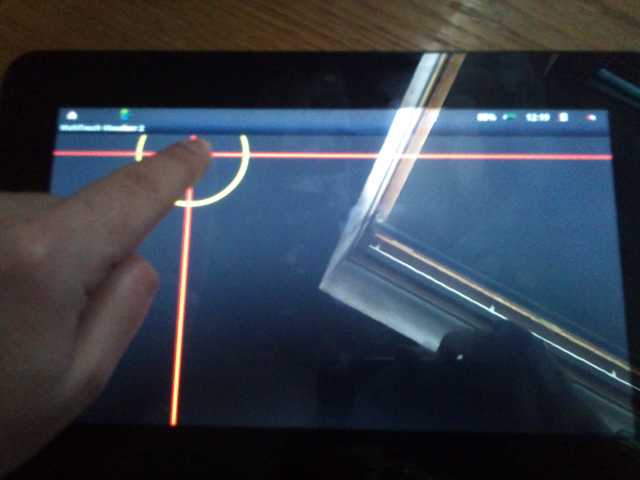

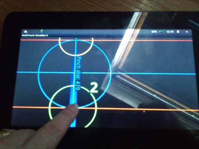

Guest piran Posted February 15, 2011 Report Posted February 15, 2011 (edited) Just got into it through droidexplorer and installed multitouch visualiser..... any touch at the top 1- 1.5 cm shows as a single touch 1.5cm from the top of the screen (I don't remember how this app treats touches outside the app window) any touch at the top 1.5-3 cm of the screen shows on ok anything below that registers as a double touch one at 1.5cm from the top and the other wherever I have my finger if I slide my finger onto the screen from the bottom the first register is 1.5cm from the top before it picks up the second touch at the bottom Edited February 15, 2011 by piran
