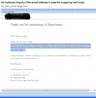

Guest Jamie :) Posted February 16, 2011 Report Posted February 16, 2011 REPLY FROM LG! ----------------------------- I think im just going to send it away to LG , as even though i'm happy with code and kdz etc. i dont think i know the phone as well as the manufacturer , so im going to send it to them :D In the reply they told me to do a strange key combination... It's in the attachment , has anyone ever tried this as it wont work on the 'BLUE ERROR HANDLER' ARM11 IS CRASHED' screen....
