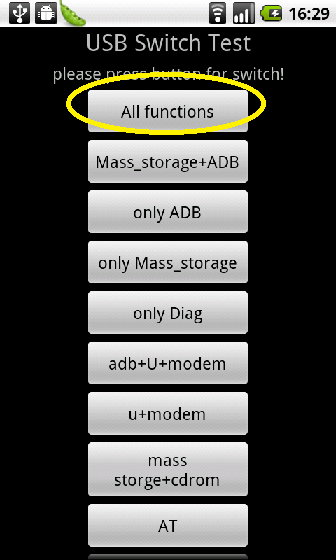

Guest burstlam Posted April 2, 2011 Report Posted April 2, 2011 did u try to enter the engineer code "*983*87274#" with the bundled dialer? click on "ALL Functions", ADB should be enabled this method works on the chinese retail version.
