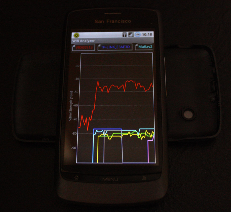

Guest C!chy Posted February 27, 2011 Report Posted February 27, 2011 Guys... I found something *very* strange... Looks like I am an owner of the faulty Blade, too bad, anyway when I was experimenting with phone I came across some strange results... If I make a gap in my phone's back cover (more than 5 mm wide on top or bottom) I suddenly see a load of WiFi access points and also I get strong and stable connection with my own router! At first I wanted to tear my phone apart to re-seat all those little connectors, but I started with the WiFi analyzer still running and suddenly... WOW! I was shocked! All those networks suddenly popped out on my screen! Looks like maybe the back plate is made of some kind of plastic mixed with a metal, that is cutting the WiFi signal out? What do you think? It's very strange..

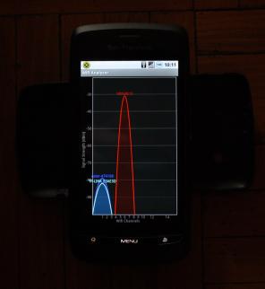

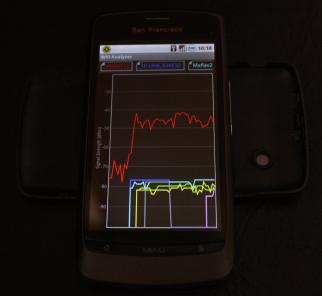

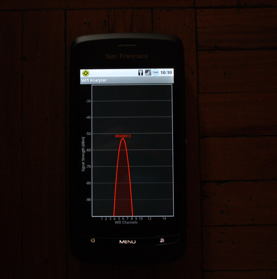

Guest C!chy Posted February 27, 2011 Report Posted February 27, 2011 But do both of you have Blade suffering poor signal issue? I can repeat this as many times I want and results are always the same for me - 1 (my own) AP visible with back cover on and even 7 APs with cover off! That is even more strange and makes me think - what the hell did they make my phone's cover with? Because it acts as a Faraday cage! See attached pictures I just took - 'before' and 'after' are from the room where my AP is and in the kitchen you can see the difference that back cover makes... Also, I tried to put some material (paper as isolator and next aluminum foil as conductor) between the back of the phone and the cover to see if this makes any difference. However, when I finally close the back cover the signal drops as usually...

Guest C!chy Posted February 27, 2011 Report Posted February 27, 2011 @wbaw: What do you mean I'm holding it wrong? I've noticed WiFi signal is weaker if I put my fingers to the top-left area on the back (where I guess the antenna is). But just see the before and after pictures - I am not holding the phone at all, as it's laying on a floor.

Guest C!chy Posted March 1, 2011 Report Posted March 1, 2011 OK, thanks for testing everyone. That's weird that no one else can confirm my observations, but I gave you the proof on my photos. So, I think I will try to replace the phone anyway, because I can't just walk around with my back cover off...
