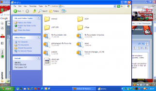

Guest pompeyrodney Posted March 16, 2011 Report Posted March 16, 2011 (edited) Do you have wifi? If you do, use that for downloading as it may save your Orange charges from racking up. The guide over at orangesanfrancisco.co.uk isn't out of date and I think it's clearer to follow than any of the other guides. Have you signed into your Google or Gmail account before trying to go to the market? You must do this first and accept the t&c's. You should then be able to access the tunyurl links to the required apps. Hi Thar So far I have managed to get wifi working and have rooted the phone, downloaded the clockwork mod program and the rom I'm going to use. I have also installed Astro file manager and an md5 tool. The snag I have now is that I am unsure how to proceed. I have clockwork 3.0.0.6, Recovery Manager 0.34b and the Rom image FLB-Froyo-blade-r10b.zip and FLB-Froyo-blade-r10b-extras.zip. The clockwork file I have is in a zip file but for some reason I cannot extract it with Astro File manager. If I just download the image again I will see how I get on from there. Thanks in advance for any help Edited March 16, 2011 by pompeyrodney
Guest andycanada Posted March 16, 2011 Report Posted March 16, 2011 (edited) Hi Thar So far I have managed to get wifi working and have rooted the phone, downloaded the clockwork mod program and the rom I'm going to use. I have also installed Astro file manager and an md5 tool. The snag I have now is that I am unsure how to proceed. I have clockwork 3.0.0.6, Recovery Manager 0.34b and the Rom image FLB-Froyo-blade-r10b.zip and FLB-Froyo-blade-r10b-extras.zip. The clockwork file I have is in a zip file but for some reason I cannot extract it with Astro File manager. If I just download the image again I will see how I get on from there. Thanks in advance for any help Someone correct me if I'm wrong, but if your have your phone rooted and installed superuser, then you can download rom manager and from rom manager you can select to install clockwork mod. You need a wifi or data connection and then it will download and install the lastest clockwork mod. After that has been completed there is an option in rom manager to install ROM from sd card. When you select this you can choose the flb-froyo-blade-r10b.zip and then it will boot into recovery and install the rom. I think that is the easiest way to do it? edit: you can also make a backup of your current rom from within rom manager as well. You should do this before you install a new rom. If the installation fails (i.e it won't boot the rom) you can boot into clockwork by pressing the volume down key while turning on the power. From clockwork you can restore your old rom. Edited March 16, 2011 by andycanada
Guest pompeyrodney Posted March 17, 2011 Report Posted March 17, 2011 Someone correct me if I'm wrong, but if your have your phone rooted and installed superuser, then you can download rom manager and from rom manager you can select to install clockwork mod. You need a wifi or data connection and then it will download and install the lastest clockwork mod. After that has been completed there is an option in rom manager to install ROM from sd card. When you select this you can choose the flb-froyo-blade-r10b.zip and then it will boot into recovery and install the rom. I think that is the easiest way to do it? edit: you can also make a backup of your current rom from within rom manager as well. You should do this before you install a new rom. If the installation fails (i.e it won't boot the rom) you can boot into clockwork by pressing the volume down key while turning on the power. From clockwork you can restore your old rom. Hi and thanks for responding. I have now installed ROM manager and this has made it much easier. I have installed FLBFroyo R10 which is sooooo much better than the standard ROM from Orange, I am now into installing loads of Apps and generally playing.
Guest Thar Posted March 17, 2011 Report Posted March 17, 2011 Hi and thanks for responding. I have now installed ROM manager and this has made it much easier. I have installed FLBFroyo R10 which is sooooo much better than the standard ROM from Orange, I am now into installing loads of Apps and generally playing. Sorry I wasn't around to respond yesterday but glad you got there in the end! :D
