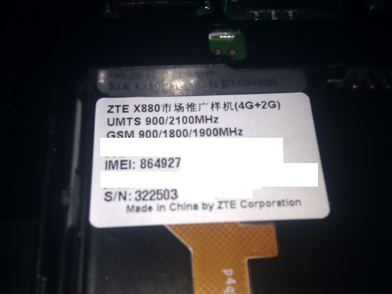

Guest noname.si Posted March 17, 2011 Report Posted March 17, 2011 So, here's the deal... I'm not sure how, but I managed to get back fastboot interface. Even tried uploading the correct version of clockwork and boot.img of the stock x880 off sebastian404's page... The green robot fades away instead of booting or anything... in case of pressing "VOL- and PWR" which should be recovery mode or just PWR for system boot... This is how it looks like... I really really hope I manage to get it back to life somehow :D

Guest burstlam Posted March 18, 2011 Report Posted March 18, 2011 (edited) If you can get fastboot, then you're back in business. There should be the whole china unicom stock rom for x880 in seb's stock rom thread. I think he did a version of clockworkmod for x880 too. Does the x880 clockwork not work? how about a blade version? It's a Chinese phone made for China, so if you speak Chinese, you might get better help at a Chinese x880 forum, they're going to know more about that phone. Hi. there from the photo posted. the label on the back show that this x880 is a sample/ display use machine. most likely a prototype, wonder how u get one. I can't find any forums with corresponding information, even with ZTE official homepage in China. I found x850 with similiar hardware. but i am not sure whether they are the same. I will post a request for u in the Zte forum. see whether the software eng. will answer it Edited March 18, 2011 by burstlam
