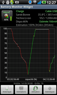

Yesterday, after a day of work and my battery down to 8% after 6H of idle ( during night ) and 12H of usage, i plug my phone to my computer to charge it.
22H time to sleep ( hey yeaaa big working day :D ) with battery @ 100% and phone set to flight mode.
This morning @ 8H30 , battery @ 99% , i set flight mode off and put my phone on my desk and come back 1 mn later :
phone is on code pin request ( reboot alone ) , i put my code pin , battery is @ 92% hmmmm - 6% just after a reboot... ok...
i reboot myself the phone and WTH !!!!! battery drop @ 14% !!!!!!!! LOOL
same apps as usual since i've my o2x and it's the 1st time that i have this problem :o
stock rom v10c , bb 405 , all upgrade by LG updater.
Take a look at the screenshoot :D

Charge it to 100% and then delete battery stats in the Recovery,under Advanced section

i find these dont like being charged by USB (500ma) only seem to like the outlet charger (1000 ma)
