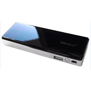

Guest Genieuk Posted June 21, 2011 Report Posted June 21, 2011 Have already ordered an external battery pack. This should keep me topped up when on a long journey, or on the way back home after work. http://www.amazon.co.uk/gp/product/B0052XMCII/ref=nosim
