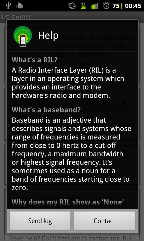

I've had this thread over at XDA for some time, so just thought I mention the app, GetRIL, here at MoDaCo as well.
GetRIL
GetRIL lets you see and change some of your Optimus 2X radio information.
Features:
  • Device support: LG Optimus 2X, T-Mobile G2X
  • See the device's current RIL & baseband
  • Recommends RIL for based on the device's baseband version
  • Recommends a baseband based on the device's RIL version
  • Backup & restoration of the RIL
  • Downloading and installation of a new matching RIL (hosted by me*)
  • Got an unknown RIL (not in the database)? E-mail it to me directly from the app and I'll try to sort things out
  • Localized to: English, Danish, Dutch, German, French, Czech, Spanish, Italian, Swedish, Russian**
  • ROM support: LG stock, CM7, MIUI
  • RIL Database that can be updated OTA*
    Note: Some features needs Superuser and Busybox to function properly

Hello everyone! I was resently testing Gr1 with bb 0725 and same ril eu version and my phone had reboot, connection and signal problems all the time and now i downgraded to v10d with bb 0622 and 0622 v10c ril. Now everything is working fine. Tho i got now old froyo back but thats better than simcard and connection loss and reboot problems right! I recommend this setup to everyone who live in europe and want stable rom, ril, baseband combination. V10d stock rom, BB 0622 and ril 0622
Edited by Guest
Guest Squide
Just flashed 0725BB, and using your app to get 0725ril...
but it never work after a reboot.
I need to download the 0622RIL again with your app
in order to get my phone working again with the 0725BB
Edited by Squide
Guest morckx
I think it has been said several times now that Gr1/Gr2+ 0725BB combination only seems to work with the 0622 Gingerbread leak RIL. No need to flash back to Froyo...
Guest Squide
seems the current 0725 RIL only work for Froyo?
that's why we need the gingerbread leak for Gr1/2
Guest sibbor
That sounds weird. Can you please do exactly like before, but this time hit the menu button - Help - Send log, afterwards? This way I can see what's going on. Thank you!
