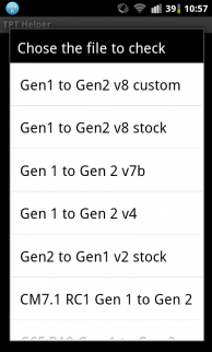

TPT Helper is designed to help you to easily repartition the phone and convert it to Gen 2 to let you run the latest custom ROMs. You should only use the TPT files included on European ZTE Blades.
Features:
*Download TPT files giving different partition layouts
*Download TPT files which will convert and install a ROM in one go
*Build your own TPT choosing partition size, recovery and splash image (in the given range)
*Start the TPT from inside the app on some roms, no need to use the hardware buttons manually
*Check the file is intact
*Unzip the TPT files to the correct location
*Verify that all the files you're about to flash are intact
*Clean up afterwards to avoid accidental flashes

I've uploaded v1.3 to the market. Changes:
*Added option to check md5, unzip and verify image folder all in one step
*Added adverts
*Added more info about each downloadable TPT on long click
*Power off button should work more reliably now
*Added cancel option when picking the file to unzip/check md5sum
*Added more feedback after unzipping/checking md5sum
*GSF TPT should unzip properly now
*Added battery level check before powering off to start TPT
