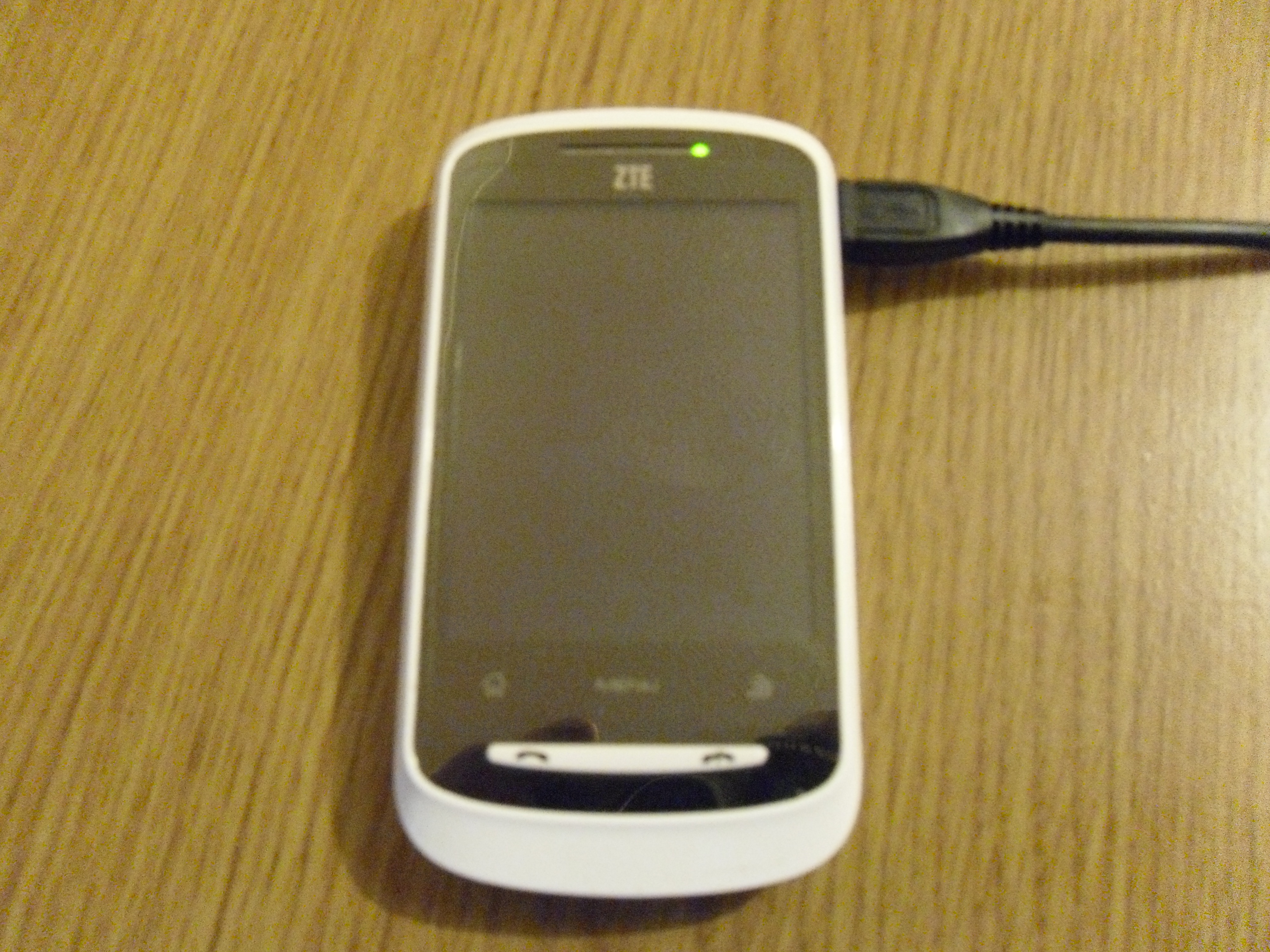

Guest Racerboy Posted September 24, 2011 Report Share Posted September 24, 2011 event0 all virtual keys, home,menu,back and the main touch screen event1 virtual home,menu,back. hard keys vol- vol+ make call,end call event2 only output is when the phone is awake, sleeps no output only power button reacts, 2 results everytime you press power button,wake,sleep Link to comment Share on other sites More sharing options...
Guest t0mm13b Posted September 24, 2011 Report Share Posted September 24, 2011 Okie, by the off chance, and am genuinely curious as to how you got the home/back key on evtest /dev/input/event1 What physical hardware keys do you have on it? For the blade, we have Home key, Menu Key and back key.... I could reprogram it to use the home key instead of power button, and make it more consistent with what's on the blade? What do you think? :) Link to comment Share on other sites More sharing options...
Guest Racerboy Posted September 24, 2011 Report Share Posted September 24, 2011 physicals on racer are: power button on the top vol- vol+ on the right side of phone make call (green phone symbol) and end call (red phone symbol) home, menu and back are all virtual keys in the middle between make call/end call and the main touch screen sounds a good idea if it works :P Link to comment Share on other sites More sharing options...
