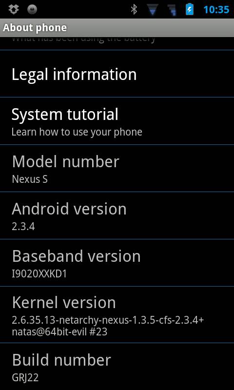

I have recently bought a secondhand Nexus S which is already rooted and has an unidentified custom ROM installed. The notification drop down says Genexus at the bottom, and the other details are as per the screenshot below.
post-772382-0-71686300-1316352182_thumb.
The battery life on it is appalling, so I'd like to get it back to stock and/or install CM7 on it to see whether that improves things (of course, it may be that it just needs a new battery, but I'm also a little nervous about it running a ROM I don't even know the name of). I also have a Motorola DEXT and maybe a ZTE Blade (Orange San Francisco) that I'd like to root and update at some point, but I'd rather start with something that should be a little easier!!

To at least get back to stock, try this link:
http://theunlockr.com/2011/01/20/how-to-unroot-the-nexus-s/
