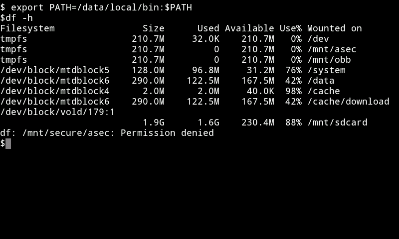

Guest sm4tik Posted October 14, 2011 Report Posted October 14, 2011 ..now what can I say.. Amphoras, THANK YOU SO MUCH :D Used your tpt with a Finnish Saunalahti gen2 blade. First try went straight through the green android back to CM, next took the battery out, put it back, booted with menu + vol-up and tadaa. Restored my backup and everything's just fine! All I have to do now is to find some use for those extra ~60MB in /system.. already have gapps and can't really think of anything usefull ;)
Guest Amphoras Posted October 14, 2011 Report Posted October 14, 2011 ..now what can I say.. Amphoras, THANK YOU SO MUCH :D Used your tpt with a Finnish Saunalahti gen2 blade. First try went straight through the green android back to CM, next took the battery out, put it back, booted with menu + vol-up and tadaa. Restored my backup and everything's just fine! All I have to do now is to find some use for those extra ~60MB in /system.. already have gapps and can't really think of anything usefull ;) Nice, glad it worked ok. What size of /system partition would you like and I can make another?
Guest sm4tik Posted October 14, 2011 Report Posted October 14, 2011 Nice, glad it worked ok. What size of /system partition would you like and I can make another? If it's not a big thing, 128MB sounds like plenty of room to play with whatever I might end up including in my build of CM7. You made my good week even better.. new job and now this (THE thing I've been waiting for since I got my blade in March!). Thanks again!
Guest Amphoras Posted October 14, 2011 Report Posted October 14, 2011 (edited) If it's not a big thing, 128MB sounds like plenty of room to play with whatever I might end up including in my build of CM7. You made my good week even better.. new job and now this (THE thing I've been waiting for since I got my blade in March!). Thanks again! Here you go :) http://dl.dropbox.co...-128sys-tpt.zip MD5sum: 6f44b3c4d292d079d11b2895b8173e8d Edited October 15, 2011 by Amphoras

Guest sm4tik Posted October 15, 2011 Report Posted October 15, 2011 (edited) Here you go :) http://dl.dropbox.com/u/41652192/TPT%20Helper/Gen2-128sys-tpt.zip MD5sum: 8ed7b72606b804b8331e68e411fd98b1 :D edit: btw, there's no "image" directory in this .zip, so if anyone else will try it out, first make a directory called "image" in the root of your sdcard and then copy the files there. Edited October 16, 2011 by sm4tik

Guest ochentay4 Posted June 26, 2013 Report Posted June 26, 2013 DONE!!! Now I have my 256RAM Blade (native gen2, probably v880) repartitioned as: SYSTEM 160Mb DATA 222Mb All other partitions w/o changes. Thanx again. Wow thanks! This is exactly what I was looking for! Could you explain how to apply this image.bin on my ZTE Blade V880 Chinese Unicom phone?
