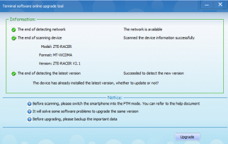

Guest lfernandes Posted November 11, 2011 Report Posted November 11, 2011 (edited) lfernandes, Read the manual. Select English at the start of installation. That's strange, no language selector at the start of installation, everything is in chinese. Couls you try it? the link: http://wwwen.zte.com...obile/Portugal/ the phone is the softstone. Tank's edited: I've manage to change language, thank's I think the upgrade, not update is the same that is in the TMN page: http://www.tmn.pt/Po...n_softstone.zip I didn't install it because it requires FTM and I have clockworkmod, but I thnk is android 2.1 with some room changes to correct some bug's, like wifi that some times had bad funcions. Edited November 11, 2011 by lfernandes
Guest Racerboy Posted November 11, 2011 Report Posted November 11, 2011 yep i can confirm there is NO kernal update or GEN2 update it is just software update only, i reflashed old original stock recovery.img to gain FTM mode and did the upgrade, so unless you are using stock rom 2.1update1 there is no benefit but software updates :(

Guest Racerboy Posted November 11, 2011 Report Posted November 11, 2011 (edited) Hi , can someone just tell me what this thread is about?? is it to offically upgrade the racer?? could somone please debrief me please? yep i can confirm there is NO kernal update or GEN2 update for 3UK RACER it is just software update only , i dont know about the other versions available, i reflashed old original stock recovery.img to gain FTM mode and did the upgrade, so unless you are using stock rom 2.1update1 there is no benefit but software updates :( Edited November 11, 2011 by Racerboy

Guest Racerboy Posted November 11, 2011 Report Posted November 11, 2011 (edited) 3UK_P726GV1.0.0B05 is 2.1-update1 (gen1) same as release version but with newer software and bug fixes kernal 2.6.29 ZTE-Kernal@Zdroid-SMT Baseband 3uk_P726GB01 Edited November 11, 2011 by Racerboy
