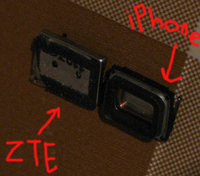

7. You can see now together 2 speakers
post-874131-0-09626100-1326439338_thumb.

Testing of speaker showed, that really problem was with it. With new one sound is not metallic or distoreshed.
But new IPhone speaker is really silent. So I think that speakers have different incoming resistance, but look similar.
The volume is lower than it was, but it is enough to talk =) So I can use ZTE again! Thank every one who helped!

Hi, Yes the speech is about ear speaker. I used the same speaker as from ebay link (here it is). May be You`ll be lucky, i have just bought it in Ukraine, it may be not original.
sound volume is lover on 35-45%. My old Nokia shouts, if differ with it. I had no possibility to try it in loud places, but I think it`ll be hard to hear person. So I think I`ll try speaker from K810i next.
