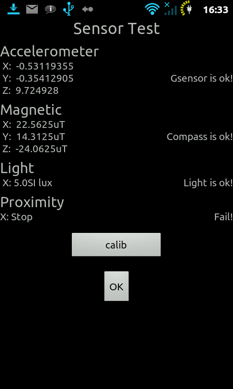

Guest soami Posted January 28, 2012 Report Posted January 28, 2012 (edited) I've found that compass doesn't work correctly. E.g. app google sky map is useless - I can turn arround and map's still showing East.I've tested it (*983*0#) and sensors are OK, but compass data doesn't look OK - X=13, Z=-45. Phone on the table. Also accelerometer still shows data in one axis. Is it normal? Or is any application for calibration? If I press "calib" in sensor test it shows "proximity calibration is OK". Edited January 28, 2012 by soami

Guest soami Posted January 29, 2012 Report Posted January 29, 2012 Yes, exactly. It goes opposite way (or showing eastwards). You can see on picture - phone was horizontally on the table but values of compass are strange.I'd appreciate any advice.

Guest soami Posted February 1, 2012 Report Posted February 1, 2012 I reinstalled Crescent ROM and then RLS1 to check if there is compass OK. it wasn't. I flashed back Fish and Chips RLS2 and made again sensor test. Compass still doesn't work properly but compass data are different - phone was in same position.

Guest soami Posted February 1, 2012 Report Posted February 1, 2012 (edited) I can try evening. I've got downloaded stock ROM but I forgot to try it yesterday... Edit: In stock ROM no change - same situation as in custom ROMs. I'm using "Ulysse Gizmos compass" and it works fine. So my only problem is skymaps which is unimportant. Edited February 1, 2012 by soami
