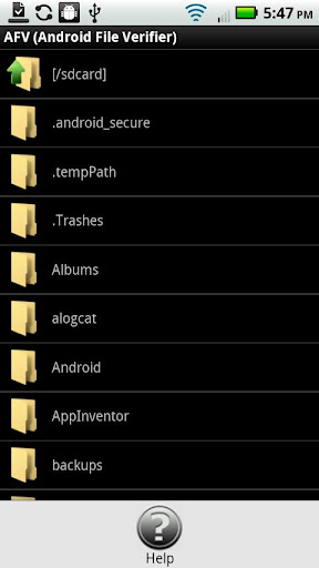

Guest OtherguyX Posted March 9, 2012 Report Posted March 9, 2012 Instructions Copy a Gen2 rom zip file to your sd card ready to install. Check the md5sum of that against the source (you can use AFV for this). Unzip this Gen2 TPT zip file to your sd card, it should create an image directory. Check the nandroid.md5 file in the image directory on your sd card using AFV on your phone (long press on nandroid.md5 file, then Verify Nandroid Backup) Power off, wait a few seconds, then power on with menu & vol+ held. It should take a few seconds to flash the new Gen2 firmware (you should see some green text), then it should reboot into ClockworkMod recovery, use that to wipe data & then install your Gen2 rom. Once installed, remove the image directory from your sd card, to prevent accidentally reinstalling. Once you have installed this just vol+ & power on will send you back into tpt mode if there is an image directory, even if you needed menu & vol+ before. It is reversible using any Gen1 full TPT (links below), but this will only work on phones that have been upgraded using this method, not phones bought with Gen2 or upgraded with the windows software. i dont understand this... what do i need to check in terms of md5sum? So i unzip the gen 2 tpt as an image file... thats it? i thought there was a tpt app on the market and you do it that way.... what the hell is nandroid... md file,,, i dont get this at all!!! please can someone tell me an easy way to do this! its all so confusing!!!!

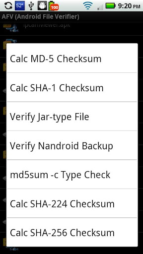

Guest Android-Fan Posted March 10, 2012 Report Posted March 10, 2012 1) I downloaded the TPT version of the ROM which did gen1 to gen2 too 2) It installs it onto the phone you don't need the zip or the image folder afterwards 3) Backup apps with clockwork as for clockwork - the problem is if you upgrade to gen2 the gen1 backup won't be any use I think 4) yes 5) I used: http://www.pc-tools.net/win32/md5sums/ 6) Both - you check the md5sum of the zip file with the post in the forum Then the files either with the check image folder option in 'TNTHelper' or on your computer - unfortunately this failed for on my pc and the phone but the files were ok (manually compared md5 of each file with the contents of nandroid.md5 when opened in a text editor) 7) Don't know 8) I chose 'Star TPT' from helper app and it restarted and did everything itself - the next time I had to do something was when the new rom was installed and I entered my google account details 9) Don't know 10) It should be update.zip or a folder called 'image' I guess - either way of deleting is ok
Guest youngsta2010 Posted March 10, 2012 Report Posted March 10, 2012 (edited) 1. Yes you can remove it. 2. It installs on the phone you can delete it. 3. Both. 4. Yes. 5. Install AFV from the market. 6. Both, long press on the zip and choose calc md5 checksum check it against the one with the download if it matches unpack it then go into the image folder long press on nandroid.md5 and choose verify nandroid backup 7. If it says failed or mismatch download and recheck. 8. Automatically. 9. ? 10. You need to unpack the image FOLDER to the root of your SD card, not in any folders. Edit: lol you beat me to it :P Edited March 10, 2012 by youngsta2010

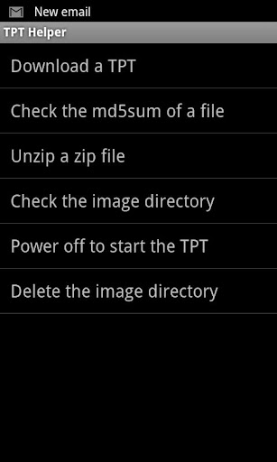

Guest Amphoras Posted March 10, 2012 Report Posted March 10, 2012 1) Doesn't matter if you remove it or not. 2) It gets installed to the phone. Once you have flashed it with Clockwork, you can delete it. 3) Doing both is best 4) Yes 5,6) If you use the all in one option in TPT Helper, it will do all the checks automatically. 7) Then you need to try again, the file has got corrupted at some point. 8) It should do it automatically, you shouldn't have to hold anything. 9) If it can't start the TPT when you click the start TPT button, then you need to turn the phone off. Then hold the menu and vol+ buttons, and turn it back on again. You should see the green text, then it should boot into clockwork. Once it does that you can flash Swedish Snow. 10) Its just on the root of the sdcard, you can delete it with any file manager or via the computer.

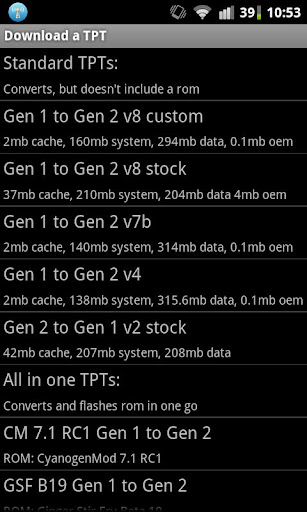

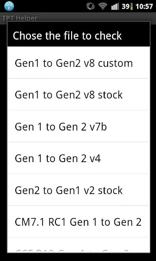

Guest Amphoras Posted March 10, 2012 Report Posted March 10, 2012 https://lh5.ggpht.co...dV7OZ89NpxuwMzA This is a picture from an older version. If you download the latest version from the market, then the first option will be "All In One". Click on that and you will get a list. Choose "Gen 1 to Gen 2 v10a". It will then start downloading the TPT, just wait and watch the screen. After the downloading bar gets to 100%, it will then show that its checking the md5sum of the file it downloaded. If that matches, it will then tell you that its unzipping it. Once it finishes unzipping, it will then check all the files inside the zip match the md5sums. Once it is finished, it will tell you "Number of matches: 17/17" if they all match. It it says any didn't match, or fails at an earlier stage, then you need to go back to the first screen and try again. If everything matched in the previous step, go back to the first screen. Make sure your battery is well charged. You should see an option called "Start TPT". Click on it, and it will ask if you have checked the image folder yet. If everything matched at the previous step, then click yes. Your phone should then reboot, and you should see the green text on the screen. Once it completes, your phone will reboot into clockwork recovery automatically. Once it gets here, flash the Swedish Snow zip you downloaded to your sdcard. Once you have flashed Swedish Snow, use TPT Helper, or any file manager to delete the image folder from your sdcard. This makes sure you don't start the TPT again by mistake.
