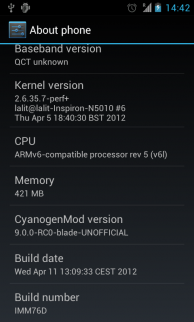

Guest sej7278 Posted April 11, 2012 Report Posted April 11, 2012 (edited) sej, can you check if the apk's still have all the unnecessary mdpi/xhdpi/etc.. stuff in them. I see those in 04/07 CFX, so I guess device_blade.mk has been updated after that build to include +PRODUCT_AAPT_PREF_CONFIG := hdpi +PRODUCT_AAPT_CONFIG := normal hdpi Just curious because this has been something bugging me since the first AOSP build. Thanks. no its just the hdpi in the build i did yesterday. i just flashed my build (took 54mins to compile) and noticed a couple of odd things: first off setting debug.sf.nobootanimation=1 in device/zte/blade/cm.mk doesn't work i still get the bootanimation (it doesn't echo 1 > /data/property/persist.sys.nobootanimation) i'm not sure if its related to that, but my boot animation is now shrunk to about half its size. oh and you're better off loading oi file manager from market as if you use the zip it seems to be uninstalled when you reflash. also noticed that changing ro.modversion in vendor/cm/config/common.mk doesn't change the filename of the resulting zip (update-cm-9.0.0-RC0-blade-UNOFFICIAL-signed.zip) or the info shown in settings->about phone->cyanogenmod version, it does seem to change the string that rommanager reports though. i guess now they're using ro.cm.version ? PRODUCT_PROPERTY_OVERRIDES += \ ro.cm.version=$(CM_VERSION) \ - ro.modversion=$(CM_VERSION) + ro.modversion=$(CM_VERSION)-sej$(shell date +%Y%m%d) Edited April 11, 2012 by sej7278
