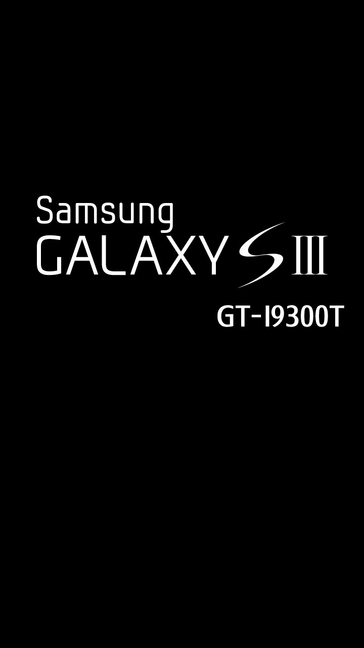

Since I have been wanting to change the boot logo in param.bin, I decided to write a program to dump the contents since I new it contained images.
Below are the 26 images (JFIF) I have extracted and their sizes.
The boot logo (image 14 - 44.91kb) is at offset 0x6c000.
I have yet to make any changes as I am still thinking about the best approach.
EDIT: Thanks to Odia@xda-developers, the param file is a plain .tar file. Therefore, it should seem easy to replace the logo.img file.
EDIT2: logo.jpg is also in the Sbl.bin partition (8 images) - it seems to override what's in the param.bin partition - no boot logo change with this model I guess.
