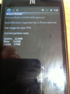

I have following the steps below to flash with CM7 (stable) with my ZTE V880 (Chinese)
1. Install ClockworkMod Recovery
1. Place CM7.2 stable as update.zip
2. adb reboot recovery into recovery mode
3. wipe stuffs...and install
4. Bootup to CM7, the phone is in airplane mode
5. Failed to disable the airplane mode and remain "No Service"
Anyone can help? Thanks....
# Attached is my Blade Checker result
post-993205-0-92733100-1347693812_thumb.
