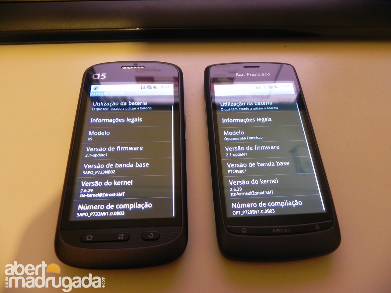

Guest KonstaT Posted October 3, 2012 Report Posted October 3, 2012 Well, I correct myself, Sapo A5 = rebranded ZTE Libra (and so is SFR StarTrail in France). Do a quick google image search and see for yourself. ;) Casing is pretty much the only difference anyway. P729 = Blade & rebranded versions P733 = Libra & rebranded versions Sapo A5 has always been P733. Even eclair for Sapo A5 is P733. See stock ROMs thread. http://www.modaco.co...ade-stock-roms/ TMN (Portugal): Sapo a5 SAPO_P733NV1.0.0B03 ro.build.version.release=2.1-update1 ro.build.date=Tue Nov 23 09:59:54 CST 2010 ro.build.sw_internal_version=SAPO_P733NV1.0.0B06 ro.build.display.id=SAPO_P733NV1.0.0B03 ro.com.google.gmsversion=2.1_r12[/code] There's more Libra/Sapo A5/StarTrail P733 ROMs in xda thread. http://forum.xda-dev...d.php?t=1353526 Like I already said, baseband that is displayed in 'about phone' menu has nothing to do with the radio firmware. You can change it to what ever you want by editing that single line in build.prop. If you install a Libra ROM to a Blade you'll also have P733 baseband (just because it says so in build.prop). Edit. nuff said. ;) http://2.bp.blogspot.com/_GFo2NhVEkEk/TTjG8KSsIyI/AAAAAAAAM1U/nM2cV7LyJkE/s1600/DSCN4678.JPG
