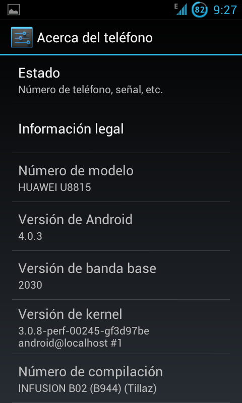

HELP! Modify the frequency of 2100 MHz (SPAIN) TO 1900 MHZ (CHILE). IN HUAWEI U8815-51
HELP!
Modify the frequency IN ICS INFUSION B02 (B944)
2100 MHZ (SPAIN) TO
1900 MHZ (CHILE). IN HUAWEI U8815-51 IN OPERATOR MOVISTAR ..
LATEST BASEBAND 2030, ICS INFISION B02 B944.
THE WORKS WITH 3G MOBILE TO CHANGE A YOIGO SPAIN ..
(GINGER GOOD 3G 2.3.6 => 4.0.3 ICS BAD3G)
WHEREAS, it is clear that you can change frequencies, it is by software and not hardware.
Anyone know how to modify and where the file ....
ZIP TO MODIFY ANY FREQUENCY MHz from CWM ...
Some manual I find nothing in NETWORK concerning the case.
post-997601-0-88737500-1351689821_thumb.post-997601-0-27547500-1351689863_thumb.post-997601-0-45980800-1351689875_thumb.post-997601-0-14908600-1351689899_thumb.
AYUDA!!
MODIFICAR LA FRECUENCIA
2100 MHZ(ESPAÑA) TO
1900 MHZ (CHILE). EN HUAWEI U8815-51 PARA EL OPERADOR MOVISTAR..
BASEBAND ACTUAL 2030, ICS INFISION B02 B944.
EL MOVIL FUNCIONA CON 3G HASTA EL CAMBIO A YOIGO ESPAÑA..
(GINGER 2.3.6 FUNCIONA 3G =>ICS 4.0.3 NO FUNCIONA 3G)
POR LO CUAL, ESTA CLARO QUE ES POSIBLE MODIFICAR LAS FRECUENCIAS, YA QUE ES POR software Y NO hardware.
ALGUIEN SABE COMO MODIFICARLAS Y DONDE SE ENCUENTRA EL ARCHIVO....
ALGUN ZIP PARA MODIFICAR LA FRECUENCIA MHZ DESDE EL CWM...
ALGUN MANUAL NO ENCUENTRO NADA EN LA RED REFERENTE AL CASO.
post-997601-0-19189300-1351689847_thumb.
