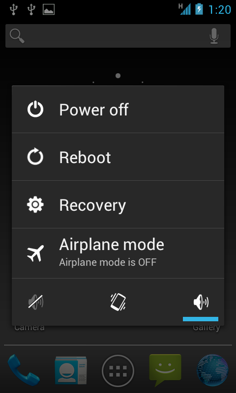

Guest tillaz Posted March 1, 2013 Report Posted March 1, 2013 THIS GUIDE IS ONLY FOR STOCK BASED ICS ROMS ON THE G300 (i will provide a flashable.zip for people who don't want to try them self) PLEASE DO NOT PM ME WITH YOUR PROBLEMS, POST IN THE THREAD WITH YOUR MODIFIED FILES ATTACHED things you will need from your ROM framework.jar framework-res.apk android.policy.jar Tools you will need to work with (links provided) notepad ++ > http://notepad-plus-...nload/v6.3.html 7zip > http://www.7-zip.org/download.html jar decomplier / recomplier > http://ubuntuone.com...B9DlVRiSPtmmPtM (How To Use) apk manager > http://ubuntuone.com...iGEQawtXvjzLq�� (How To Use) FIRST: adding resources to the framework-res.apk start by decompling framework-res.apk with apk manager navigate to projects\framework-res.apk\res\values\public.xml using notepad ++ search <public type="string" name="contact_status_update_attribution" id="0x0104051d" /> below this add the following code <public type="string" name="reboot_ics" id="0x0104051e" /> <public type="string" name="recovery_ics" id="0x0104051f" />[/code] now search [code]<public type="drawable" name="stat_sys_upload_done_static" id="0x010805e6" /> below this add the following code <public type="drawable" name="reboot" id="0x010805e7" /> <public type="drawable" name="recovery" id="0x010805e8" /> [/code] [b]save and exit[/b] navigate to projects\framework-res.apk\res\values\strings.xml add the following code below <resources> [code] <string name="reboot_ics">Reboot</string> <string name="recovery_ics">Recovery</string> save and exit download the resorces from the link below and add the two .png images to projects\framework-res.apk\res\drawable-hdpi LINK :http://www.solidfile...m/d/43dbd2924d/ now recompile the framework-res.apk DO NOT SIGN IT! SECOND: shutdown thread decompile framework.jar with "jar decompiler / compiler" navigate to classout\com\android\internal\app delete the whole of huawei's shutdown thread, all files that start with > ShutdownThread it should be the last eight files in the folder now add my modified shutdown thread, copy all the files in the link below to the folder classout\com\android\internal\app LINK: http://www.solidfile...m/d/d0ae175b78/ now we are done with the framework, compile it and add the new classes.dex inside the framework.jar (use 7zip) delete the classes folder as we are finished with that THIRD: global actions decompile android.policy.jar with "jar decompiler / compiler" navigate to classout\com\android\internal\policy\impl\GlobalActions.smali open it with notepad ++ use the search function and search > .line 187 delete all code from and including .line 187 up to .line 212 (delete all code shown below) .line 187 const-string v0, "true" const-string v1, "ro.config.hw_quickpoweron" invoke-static {v1}, Landroid/os/SystemProperties;->get(Ljava/lang/String;)Ljava/lang/String; move-result-object v1 invoke-virtual {v0, v1}, Ljava/lang/String;->equals(Ljava/lang/Object;)Z move-result v0 if-eqz v0, :cond_5f .line 188 iget-object v9, p0, Lcom/android/internal/policy/impl/GlobalActions;->mItems:Ljava/util/ArrayList; new-instance v0, Lcom/android/internal/policy/impl/GlobalActions$3; const v4, 0x202000b move-object v1, p0 move v2, v12 move v3, v12 move v5, v11 move v6, v11 invoke-direct/range {v0 .. v6}, Lcom/android/internal/policy/impl/GlobalActions$3;-><init>(Lcom/android/internal/policy/impl/GlobalActions;IIIII)V invoke-virtual {v9, v0}, Ljava/util/ArrayList;->add(Ljava/lang/Object;)Z [/code] now below [b].line 212[/b] delete [code] :cond_5f OK, that's huawei's stuff removed, now we can add my code add the following code above .line 212 iget-object v0, p0, Lcom/android/internal/policy/impl/GlobalActions;->mItems:Ljava/util/ArrayList; new-instance v1, Lcom/android/internal/policy/impl/GlobalActions$9; const v2, 0x10805e7 const v3, 0x104051e invoke-direct {v1, p0, v2, v3}, Lcom/android/internal/policy/impl/GlobalActions$9;-><init>(Lcom/android/internal/policy/impl/GlobalActions;II)V invoke-virtual {v0, v1}, Ljava/util/ArrayList;->add(Ljava/lang/Object;)Z iget-object v0, p0, Lcom/android/internal/policy/impl/GlobalActions;->mItems:Ljava/util/ArrayList; new-instance v1, Lcom/android/internal/policy/impl/GlobalActions$10; const v2, 0x10805e8 const v3, 0x104051f invoke-direct {v1, p0, v2, v3}, Lcom/android/internal/policy/impl/GlobalActions$10;-><init>(Lcom/android/internal/policy/impl/GlobalActions;II)V invoke-virtual {v0, v1}, Ljava/util/ArrayList;->add(Ljava/lang/Object;)Z [/code] [b]save and exit [/b] add the two files in the link below to classout\com\android\internal\policy\impl\ [b]LINK: [/b]http://www.solidfile...m/d/cb277673ef/ now we are done with android.policy, compile it and add the new classes.dex inside the android.policy.jar (use 7zip) delete the classes folder as we are finished with that [b]FOURTH:[/b] check your build.prop for this line and change it to false ro.config.hw_quickpoweron=true [b]done... add the new files to your ROM[/b] framework.jar framework-res.apk android.policy.jar

Guest Cyda Posted March 1, 2013 Report Posted March 1, 2013 (edited) Big thanks for this, tillaz. I've never looked at adding extended power menu options before so some of this was new to me but that guide was very easy to understand and follow. I now have a power menu recovery option in the dev build of Stock+. Job well done. :) Edited March 1, 2013 by Cyda
Guest cicki Posted March 1, 2013 Report Posted March 1, 2013 many thanks for share this mod, explains very understandable, has worked at first attempt, again thank you

Guest kyan31 Posted March 3, 2013 Report Posted March 3, 2013 (edited) Yay, it worked perfectly! I also added custom settings, :) Thanks SO much Tillaz, your awesome dude ;) Now lightning ROM has a new boost of energy Edited March 3, 2013 by kyan31
