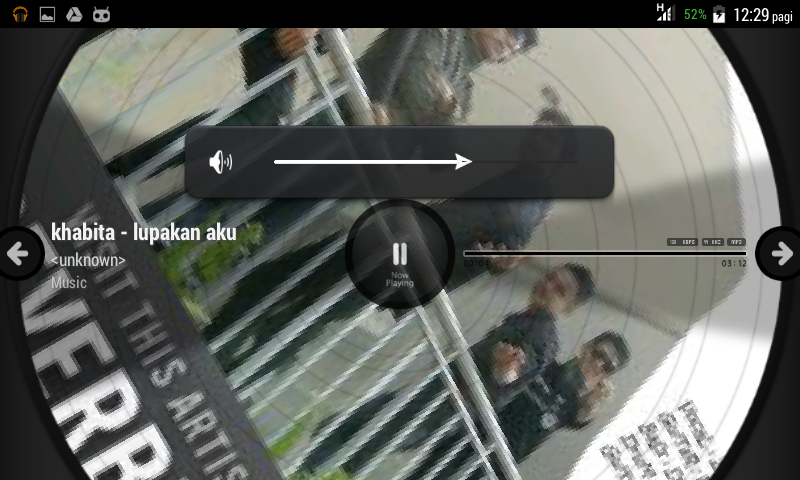

Guest Ucup budug
Salamm ...
Please read and look carefully before starting the installation.
CROSS A26 | PRESTIGIO MULTIPHONE 5000 or 4500 | LAVA IRIS 501
All in frimware : Jellybean 4.2.2
## # # Version 1
Open: http://wp.me/p25CDy-ta
## # # Version 2
Open: http://wp.me/p25CDy-tj
## # # Version 3
Features and Description:
1. Transfarant applications: Contacts, SystemUI, Calculator, Youtube, Radio, SoundRecoder, framework. 2. Boot logo and boot animation kitkat Google android 4.4
3. Android 4.4 Ui Kitkat
4. Adding apps from android kitkat: Current, Hangout, googleNow, Velvet, GoogleHome, GoogleKeyboard, Gmail2, Exchange Email, Maps, GoogleQuicksearch, QuickOffice.
5. Gallery and camera google android 4.3
6. RootExplorer, Viper4android, GravityBox, XposedAppSettings and XposedInstaller for the advanced user.
7. SU binaries, do not need superuser permission for applications that need to be rooted.
8. Fixed Wifi, GPS, Bluetooth, long read SDCard and boot into recovery mode menu.
9. I set the lowest DPI HDPI = 182
10. BSplayer Pro as a replacement for the videoplayer deleted.
11. Kitkat Roboto font and Unicode Font-reguler.ttf Droidsansfallback.ttf
13. The theme is fully based on Google Android Nexus kitkat.
Terms mounting:
- Rooted
- Installed CWM / TWRP recovery
The installation instructions:
- Download and save the file A26.JB.4.2.2.v3
- Go to recovery (CWM or TWRP)
- Select Delete data and cache
- Select Delete Cache partition
- Select Advanced, then Delete Dalvik cache and back.
- Select Choose Zip ... then select Install zip from sdcard, find where the files are downloaded rom then select and install
- The phone will automatically reboot
- Log in and enjoy the new rom.
File Name:
A26.JB.4.2.2.v3.zip
Download Link: Http://goo.gl/nJco63
Free system : - + 65 Mb
Free ram first started: - + 220 Mb
Details specification: http://goo.gl/l9EAMa
This rom costumes can be compatible with LAVA IRIS 501 / Prestigio Multiphone 5000, Prestigio multiphone 4500? Notice how below:
- LAVA IRIS 501 multiphone and Prestigio multiphone 5000 : After installing the rom, replace / system / usr / keylayout / mtk-tpd.kl of your stock rom (Use RootExplorer.apk), set permissions to rw-r-r and reboot .
- Prestigio multiphone 4500
1.Unpack A26JB.4.2.2.zip
2. Replace these files from your 4.2.2 rom base:
boot.img
Logo.bin
/ System / etc / firmware / modem.img
/ System / usr / all files
/ System / vendor / all files
3. Pack back into. Zip
4. Install and enjoy.
Note:
- Dare to install, brave bear consequences. DWYOR.
- Please develop any shortcomings in this rom costume, already fully yours.

Guest venganan
I'm testing v1 from last week. ROM isreally good and fluid. The v3 link not available. Pl update. Thanks a lot for this wonderful rom
