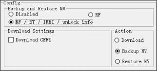

Thank you for the help...
Whether and it is possible to ask someone a backup of the present working file Channel1.nvm ?
post-1012485-0-43067800-1368712386_thumb
Or Bekap of the .qcn file which can be received the QPST program?
post-1012485-0-40113800-1368711204_thumb
