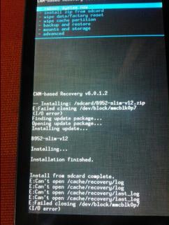

Guest Nickxdd Posted June 7, 2013 Report Posted June 7, 2013 It seems like I ve got errors in CWM see this: I will restore my stock ICS CWM backup and HOPEFULLY it will work becuase I have my phone open in CWM for about 5 mins no shut down. You are REALLY helpful till now guys thanks a ton.
Guest Nickxdd Posted June 7, 2013 Report Posted June 7, 2013 (edited) At least i think the problem is not in hardware and cwm is accessible. OK so the problem seems to be messed mmcblk0p partitions(?) I just don't understand how this happened. Any help PLEASE :'( Edited June 7, 2013 by Nickxdd

Guest Nickxdd Posted June 7, 2013 Report Posted June 7, 2013 I would try doing full wipes on the phone via CWM and the get a stock ROM dload folder saved on your memory card & then turn the phone on holding the vol+ and - keys together to flash it. Alternatively, find a .zip file and flash it using CWM after performing full wipes That will restore/fix the default mmcblk0p partitions? Factory reset(like shown in first pic) fails :'(

Guest Nickxdd Posted June 7, 2013 Report Posted June 7, 2013 Looks like the nand/emmc could be on its way out. I would try force updating a update.app. B926 always worked for me when I bricked my G300. Since this is not my phone and I have never installed official ROM to this phone, can you kindly link me to B926 and give me instructions on how to update please :) ? If installation is same with the u8800pro then its, make a dload folder in sdcard with update.app from step 1, hold power button and vol + and vol - and repeat the same for step 2 and 3, is that correct? Also by looking at my pics do you think this is fixable? I sooo worried right now :(

Guest Cyda Posted June 7, 2013 Report Posted June 7, 2013 (edited) You should be able to get the B926 update.app from here: http://www.huaweidev...softid=NDE4NjY= It might take a few tries. If that works and you get a working system you can look at updating to other versions. The reason I suggest B926 is because when I bricked my G300 (twice) the only fix was the B926 update.app, no other version (of the limited number I tried) worked for me. Your mileage may vary, of course. Also by looking at my pics do you think this is fixable? In truth, it is hard to say for sure but I'd be probably looking to warranty this about now. That said, weird things can happen with G300s so it is certainly worth trying to recover it at this stage. Edited June 7, 2013 by Cyda
