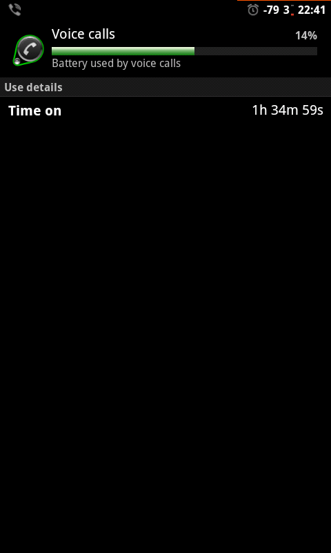

Hi everyone! I've finally done what I wanted for a long time. I've put two additional batteries in ZTE Skate :) (~1400mAh each)
Results (one full charge):
~9h Screen On
~7h Music (with screen off)
~1.5h Talking
Data always on (WiFi or 2G)
Processor @ 120-883MHz, OnDemand
GB chopped up, old Market that doesn't update
As there was no way to fit the batteries inside the case, I've put them inside a TPU case ($2 cost) without the stock back. It looks a bit funny, but i like it. Oh yeah!

Software:
post-990817-0-10821200-1380890682_thumb.
post-990817-0-29119700-1380890683_thumb.
post-990817-0-13563500-1380890684_thumb.
post-990817-0-26156100-1380890685_thumb.
post-990817-0-39602300-1380890686_thumb.

It's almost the same! Maybe 3mm thicker than with stock back door and without extra batteries. I did it just for fun, but there's no way I'm taking them off :-D
This is how a propper Android phone should be. 4Ah battery minimum. I'd love to put in a better CPU, Facebook works much better on quad-cores, but for everything else - this is just fine.
