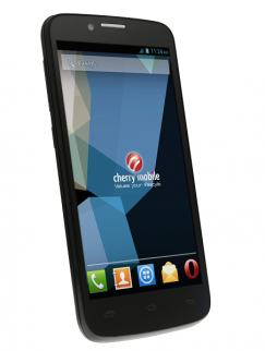

Guest excel0 Posted October 9, 2013 Report Posted October 9, 2013 (edited) OMEGA HD 2.0 XOLO Q1000 Device Information: The OMEGA HD 2.0 is a 5" smartphone by the local Philippine mobile phone brand, Cherry Mobile. It is simply a rebranded Xolo Q1000. Its specifications are completely the same as the Q1000 except for the camera resolution. Even though the OHD2 is said to have a 12MP camera it only has an 8MP one which is interpolated to capture a 12MP image. You may also notice that the OHD2 is labelled to have a qHD screen on the brand's website but this is false as the OMEGA HD 2.0 is indeed HD. Specifications: Operating System: Android Jellybean 4.2.1 Chipset: MTK 6589 CPU: 1.2 GHz Quad Core MT6589 GPU: PowerVR SGX544 Memory: 4GB ROM (1GB Internal Memory, 1GB Phone Storage/Internal SD Card, remaining for misc partitions) 1GB RAM Micro-SD card, up to 32GB Display: IPS LCD Capacitive Touchscreen 720 x 1280 pixels, 5.0", ~294ppi 5 point Multitouch Primary Camera: 12.6MP, 4096 x 3072 pixels, Interpolated LED Flash, Autofocus 1080p video recording @ 30fps Secondary Camera: 1.9MP 1600 x 1200 pixels Battery: Li-on 2100 mAh Dual SIM SIM1 - 2G, 3G SIM2 2G only More Information: Because the OHD2 has a Mediatek Chipset it does not have that much freedom for development of custom ROMS because Mediatek does not provide device source codes openly unlike Qualcomm and a few others. Although some source codes have been released for the MTK 6589, there isn't seem to be much interest in developing custom ROMS like Cyanogenmod or AOKP for this phone or any other Mediatek phones. But because a lot of devices share the same Chipset as the OHD2 many have ported ROMS from these devices to this phone. The OHD2 also has 2 build numbers, 49 and 7. These can be found in the "About phone" option in "Settings". The build number is crucial when flashing ROMS because some ROMS cannot support both builds. Next post: Rooting Edited October 11, 2013 by excel0

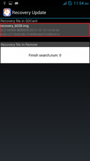

Guest SHREYAAS Posted October 17, 2013 Report Posted October 17, 2013 Hi, ive got a xolo q 1000, i had searching for the cwm recovery for a long time, thanks for the above methods, i tried it with the tool kit but it did not work, then i tried with mobile uncle tools, it got flashed successfully , thanks a lot, can you please give me the link for custom roms for xolo q 1000, it would be really helpful, thanks guys
