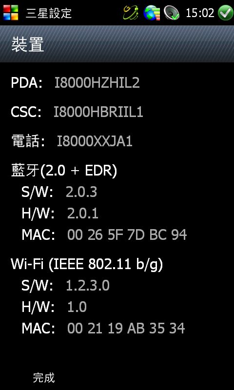

Guest Nablet Posted January 20, 2010 Report Share Posted January 20, 2010 The language is reported as Taiwanese (Traditional Chinese), is there a ROM for Simplified Chinese (Mainland Chinese)? Also how is the phone flashed? Octans doesn't recognise the ROMS because they're not MST files but nb0's and there's no .bin for the phone. Link to comment Share on other sites More sharing options...
Guest twu2 Posted January 20, 2010 Report Share Posted January 20, 2010 The language is reported as Taiwanese (Traditional Chinese), is there a ROM for Simplified Chinese (Mainland Chinese)? Also how is the phone flashed? Octans doesn't recognise the ROMS because they're not MST files but nb0's and there's no .bin for the phone. this is only for TC, not for SC. ROM for phone can use the version from secany. this is PDA ROM only, it's .nb0 format. Link to comment Share on other sites More sharing options...
Guest Nablet Posted January 20, 2010 Report Share Posted January 20, 2010 (edited) Thank you very much, I will flash using Secany's ROM. Edit: I flashed but the phone is still in English. Can someone please link me the Secany ROM used to flash this phone to Chinese? Edited January 21, 2010 by Nablet Link to comment Share on other sites More sharing options...
Guest twu2 Posted January 21, 2010 Report Share Posted January 21, 2010 Thank you very much, I will flash using Secany's ROM. Edit: I flashed but the phone is still in English. Can someone please link me the Secany ROM used to flash this phone to Chinese? secany's PDA ROM don't support Chinese. you can only use the secany's phone ROM only. you need to flash Chinese's PDA and CSC to get Chinese support. Link to comment Share on other sites More sharing options...
Guest Nablet Posted January 21, 2010 Report Share Posted January 21, 2010 I finally understand, thanks, I have downloaded all files necessary to flash the phone in Chinese but they're different versions. I hope this doesn't cause any problems but I have no choice as I need the internet on my phone fixing. Link to comment Share on other sites More sharing options...
