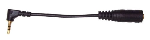

Guest razko Posted December 9, 2005 Report Posted December 9, 2005 (edited) yes, i have adaptor... it looks like that adaptor http://img394.imageshack.us/img394/1043/dscf02084er.jpg but when i connect him to my phone, the sound isn't stereo... i need to play with him to hear in the two sides... but it's also not stereo... (sorry my bad english...) Edited December 9, 2005 by razko
Guest Paraklas Posted December 9, 2005 Report Posted December 9, 2005 I understand what you mean.. if I put that adaptor I posted above on my mpx220, I don't get stereo sound, I have to pull it a bit out to get the sound in stereo. I guess you have to take your headphones and the phone to a shop and get an adaptor that matches your phone.
Guest m1.carson Posted December 9, 2005 Report Posted December 9, 2005 (edited) Hi Guys, the adaptor shown is a mono adaptor [Looby] left of photo, for stereo you need three connections, earth, left channel live and right channel live, which is two rings as shown on the headphone plug, [same photo]. One of the 200 forum discussions of a couple of days ago deals with the same subject and suggested an adaptor from PC-Mobile [or somewhere close to that name] Edited December 9, 2005 by m1.carson
Guest Looby Posted December 9, 2005 Report Posted December 9, 2005 (edited) Have just been on to www. pc-mobile.net and they do have a good selection of adapters. The one in the enclosed pic. looks like it's stereo to me. It is about £5 including delivery. Looks good. :D I have just been down to an electrical shop in my local town and found this connector for £1.50 and works a treat, as you can see it has two rings for stereo. I must add how good the sound is with the Sony headset in the picture, it's like listening to a Hi-Fi. Many thanks to all :) Edited December 9, 2005 by Looby
