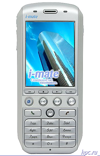

Guest mini_man Posted February 26, 2006 Report Posted February 26, 2006 I was not asking for a "rom",Oh i know, im just warning you because alot of threads seem to get closed if someone asks so im just warning you because alot of people ask when they bring up questions like this. It is possible to rebrand the SDA2 If you obtain a different rom. Im not sure what you meen by generic standard but you can definetly rebrand it with the orange rom. I need you to clear somthing up You say it looks like the SP5 Do you actually meen the SP5m The SDA looks like this It looks like the SP5 This is the SP5 But the SDA 2 is this and looks like So which SDA Do you own.

Guest pbrstreetgang Posted February 26, 2006 Report Posted February 26, 2006 Thanks for replies guys, pondrew post is correct, i have the sda2/c550. miniman the handset i have is the one shown in the last 2 pictures in your post Have spent a bit of time today with an orange sim in phone, got internet working by copying settings from my c550 but mms will not, a little more success than with the o2 sim but not quite there yet. I might take the phone to my local t-mobile shop and ask......you never know eh :oops:
