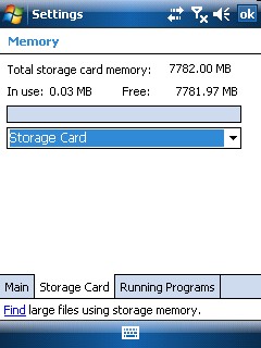

Guest Chucky7 Posted March 22, 2008 Report Posted March 22, 2008 (edited) # HP 614C IPAQ Information # Update #6 MicroSDHC Card: Well I have just put a SanDisk 8GB microSDHC card (class 4) in the HP 614C and the Memory is being reported correctly. Jase Edited March 22, 2008 by Chucky7
