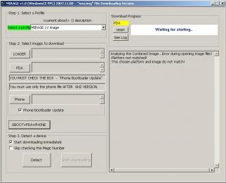

Guest thebiker Posted September 30, 2008 Report Posted September 30, 2008 (edited) Here is a short instruction on how to dump a i900: Requirements: Activesync installed Samsung Modem Driver Installed 1. Enable access to ROM by setting reg-key HKLM\Security\Policies\Policies 00001001 from 2 to 1 2. Reboot your i900 3. Download isutils to dump your ROM from http://www.mediafire.com/?sharekey=2ce11b6...2db6fb9a8902bda 4. Evaluate exact size of your ROM by typing the following at command prompt pdocread -l You will get something like 128.58M (0x8095800) DSK1: | 1.35M (0x159800) Part00 | 3.08M (0x313800) Part01 | 124.15M (0x7c27800) Part02 Which means the flash memory (=DSK1) is split in 3 partitions with total size of 0x8095800 bytes = 134.830.080 bytes 5. Dump your ROM using the evaluated flash size by typing the following at command prompt psdread -1 0 0x8095800 i900GXHI5.img Afterwards the ROM can be flashed by using Mirage LV http://www.mediafire.com/?sharekey=2ce11b6...2db6fb9a8902bda using EBOOT+PDA+PHONE button Would be great if some one could supply the new i900GXHI5.img file we are all waiting for! Hi My fried tried this method with Hungarian original rom i900XXHH9. He made the image successfully but he couldn't flash this image. He selected the profile (Mirage LV image) and selected "EBOOT+PDA+PHONE" button. And now he got error message on the right side: "Analyzing the Combined Image...Error during opening image files! -Platform not matched! :The chosen platform and image do not match!" What was wrong? I think the image isn't good but he used "pdocread -l" command. Any idea? THX for any help! The Biker Edited September 30, 2008 by thebiker

Guest albixo Posted September 30, 2008 Report Posted September 30, 2008 Good evening from Milan, i made a big mistake flashing a I908 ROM on my I900, someone can tell me how can i downgrade the ROM to the previous version? I tried using the official one but the process stops with a "Incorrect software version check your device" warning message. Thank you in advance
Guest panateo Posted September 30, 2008 Report Posted September 30, 2008 Good evening from Milan, i made a big mistake flashing a I908 ROM on my I900, someone can tell me how can i downgrade the ROM to the previous version? I tried using the official one but the process stops with a "Incorrect software version check your device" warning message. Thank you in advance Use the latest italian ROM you can find at the first post in this thread (XIHI5). The downloader coming with that ROM doesn't check the ROM region, so you can flash any i900. Ciao!
