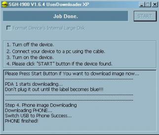

Guest Tormios Posted May 4, 2009 Report Posted May 4, 2009 Hi. Just upgrade with DXID1 phone part. Last message was JOB DONE. Phone restarted. I go to check version and what I found out, is that phone version is still old (JVHK1) Question: why? What's wrong?

Guest Tormios Posted May 4, 2009 Report Posted May 4, 2009 I would try to flash the phone part again. Thanks Khuanchai for the reply. I will try and come back with a result.
Guest Tormios Posted May 4, 2009 Report Posted May 4, 2009 (edited) Thanks Khuanchai for the reply. I will try and come back with a result. I flashed phone part again. Does not help. It's still show phone version i900JVHK1 May be need hard reset or reflash PDA part? Edited May 4, 2009 by Tormios
Guest Khuanchai Posted May 4, 2009 Report Posted May 4, 2009 I flashed phone part again. Does not help. It's still show phone version i900JVHK1 May be need hard reset or reflash PDA part? That's strange. Someone please help. Who have tried and failed like this?
Guest gianton Posted May 4, 2009 Report Posted May 4, 2009 That's strange. Someone please help. Who have tried and failed like this? I always flash phone part only, with GrandPrix.
Guest Tormios Posted May 4, 2009 Report Posted May 4, 2009 I always flash phone part only, with GrandPrix. With GrandPrix I've got same result :lol: Still show me i900JVHK1 :D Is any other way to check the phone version? I mean not in Settings/System/Version
