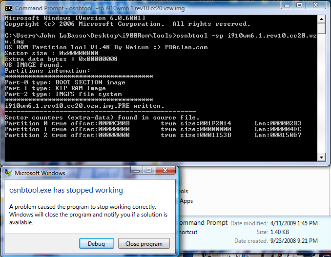

Guest Skyline987 Posted April 11, 2009 Report Posted April 11, 2009 The .nb0 is the first split from OSnbtools. Extractbin does another extraction on it. so if you do OSnbtools -sp image.img, you'll get image.img.bin.nb0. rename that file. So im running osnbtool with the exact command you posted but it only creates a .PRE file and crashes. Ive tried on Vista and XP and i get the same results :excl:

Guest WoZZeR999 Posted April 11, 2009 Report Posted April 11, 2009 (edited) So im running osnbtool with the exact command you posted but it only creates a .PRE file and crashes. Ive tried on Vista and XP and i get the same results :excl: You need osnbtool version 1.55. 1.48 doesn't work.osnbtool.zip Edited April 11, 2009 by WoZZeR999
Guest Skyline987 Posted April 11, 2009 Report Posted April 11, 2009 You need osnbtool version 1.55. 1.48 doesn't work. Awesome! Got it working! Thanks WoZZeR
