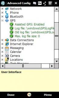

Guest ardvarkofdoom Posted April 15, 2009 Report Posted April 15, 2009 Hey guys... I really don't know if this could have any affect on anything... but I was playing around on "advanced config" and noticed that there was a section for GPS and I noticed that it says "assisted GPS: Disabled (default)". This setting can be changed to enabled. Hopefully that helps someone :excl:
Guest theidoctor.org Posted April 15, 2009 Report Posted April 15, 2009 Hey guys... I really don't know if this could have any affect on anything... but I was playing around on "advanced config" and noticed that there was a section for GPS and I noticed that it says "assisted GPS: Disabled (default)". This setting can be changed to enabled. Hopefully that helps someone :excl: how did you get to advanced config?
Guest dmk679 Posted April 15, 2009 Report Posted April 15, 2009 We need to determine if enabling agps in this program simply modifies the reg entry hklm/software/samsung/ril/gps/agpsstatus Can someone verify? On another note, if you do a hard reset or flash a new rom etc, the first time you use the GPS is known as a Factory Lock. See this link which discusses the different locks. This is different than a cold lock.
Guest Omega Ra Posted April 15, 2009 Report Posted April 15, 2009 Hey guys... I really don't know if this could have any affect on anything... but I was playing around on "advanced config" and noticed that there was a section for GPS and I noticed that it says "assisted GPS: Disabled (default)". This setting can be changed to enabled. Hopefully that helps someone :excl: my version of advanced config doesn't have that option....I have v3.3
Guest Ishman Posted April 15, 2009 Report Posted April 15, 2009 I have added the registry changes mentioned in this thread as well as the GPSone modifications. When I use the advanced configuration program, I don't get the agps option. Are others?
Guest cheifkeiff Posted April 15, 2009 Report Posted April 15, 2009 i have v3.3 and don't have that option either
Guest j0hnd0e82 Posted April 15, 2009 Report Posted April 15, 2009 do not have that option on my i910 advanced config 3.3
Guest Adrynalyne Posted April 15, 2009 Report Posted April 15, 2009 I have it. Maybe it has to be cooked in? Mine was cooked in.
Guest Adrynalyne Posted April 15, 2009 Report Posted April 15, 2009 We need to determine if enabling agps in this program simply modifies the reg entry hklm/software/samsung/ril/gps/agpsstatus Can someone verify? On another note, if you do a hard reset or flash a new rom etc, the first time you use the GPS is known as a Factory Lock. See this link which discusses the different locks. This is different than a cold lock. Not sure what it enables. I don't even have that key in the registry.
Guest theidoctor.org Posted April 15, 2009 Report Posted April 15, 2009 I have it. Maybe it has to be cooked in? Mine was cooked in. which cooked rom are you using? and can you just get me a link to it?
