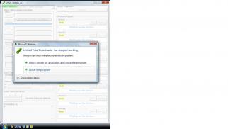

Can someone please help me. First i have downloaded all files from modaco and these threads directly. apparently my windows vista dell laptop doesnt like the UMDL program. This is my first time attempting to flash my phone. Please see pics below. as i follow the instructions, i select the file. hit detect. as soon as i turn my phone back on (it is plugged in via usb and the phone is set to be read as usb connection not active sync) the WinUSB-initialize pop up comes up. i click ok and windows tells me UMDL has stopped working. Any ideas? As far as i know i am doing everything correct. Help would be much appreciated.
jim

Same result. UMDL has stopped working. would you like windows to search the internet for a solution.... blah blah blah. I do not have much running in the backround on my laptop ( so i dont think its a memory issue b/c i know vista's a hog) It looks like no matter how i run it, UMDL will stop as soon as it detects my phone.
at this point in time its just frustrating as the phone is now again stock and it would take hours to re-install all the little gadgets i had in there. is anyone in NJ that has successfully flashed thier omnia (preferrably more than once) that i can pay you to flash mine so long as i can watch and maybe i can visually see what im doing wrong.
thanks
jim
Guest necosino
Jim, make sure the phone is COMPLETELY off, not just the screen off :) I know a few people have done that, too.. Other people have been able to do it on Vista. I use Win7 though. Try this:
disconnect your phone and TURN IT COMPLETELY OFF. Unplug the battery if you want to be 100% sure its off!
Restart your computer
Open activesync connection settings and UNCHECK ALL of the settings.
Open UMDL, select the .img, and click detect.
Plug in phone, and then turn it on, and see what happens.
Woah, hang on.. You selected Wozzer's v5 ROM. You need to flash the leaked CC20 ROM BEFORE flashing his, otherwise your phone may not work!
Go back to my first post or theidoctor.org, and download the cc20 leaked ROM, it'll be an .img file. Flash that FIRST, THEN reflash with just wozzer's pda .bin part <_<

Necosino... Thanks for all your help. basically i was not following things correctly. your post said "From Vista/7: Just plug in normally (don't change activesync settings or try to use UMDL or anything). Windows will download and install the drivers automatically. " so i thought that didnt apply to me. my problem was exactly what you said above open activesync connections and uncheck all of the settings. so therein was my problem. as soon as you had me do that it stopped getting errors and flashed correctly. and YES at first when i took those screen shots i was setting up for catastrophy by using the wrong rom. in the end im glad i did get those errors b/c it prolly saved my phone. i realized i had the wrong rom and got the right one after my post last night. just never updated that i was doing it wrong in the first place.
again thank you for all of your help. i am flashed successfully now.
