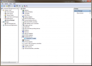

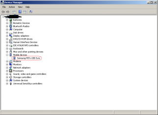

Guest bobobird Posted October 10, 2009 Report Posted October 10, 2009 (edited) One part of the instructions may be a bit confusing. The phone would connect to Windows Mobile Device Center when the usb cable is attached. This is what you will see in device manager - The trick to updating (actually downgrading from 6.xxx to 5.xxx) to the MITS Sync driver is to turn off the phone but keep it connected. A battery charging picture will appear on the phone when you turn it off and device manager will look like this - Notice that in the first pic that the O2 is shown under portable devices and in the second it shows up in Mobile Devices. After updating with the Vista drivers in the opening post, you should see this and flashing will work 100%. Hope this helps. Edited October 11, 2009 by bobobird
Guest kaplex Posted October 11, 2009 Report Posted October 11, 2009 One part of the instructions may be a bit confusing. The phone would connect to Windows Mobile Device Center when the usb cable is attached. This is what you will see in device manager - The trick to updating (actually downgrading from 6.xxx to 5.xxx) to the MITS Sync driver is to turn off the phone but keep it connected. A battery charging picture will appear on the phone when you turn it off and device manager will look like this - Notice that in the first pic that the O2 is shown under portable devices and in the second it shows up in Mobile Devices. After updating with the Vista drivers in the opening post, you should see this and flashing will work 100%. Hope this helps. Strongly agreed with bobobird. you cant downgrade MITS Sync driver while your phone is on. turn off your phone, then connect it to computer (Vista). after that you can downgrade your driver to 5. Happy flashing... :)
