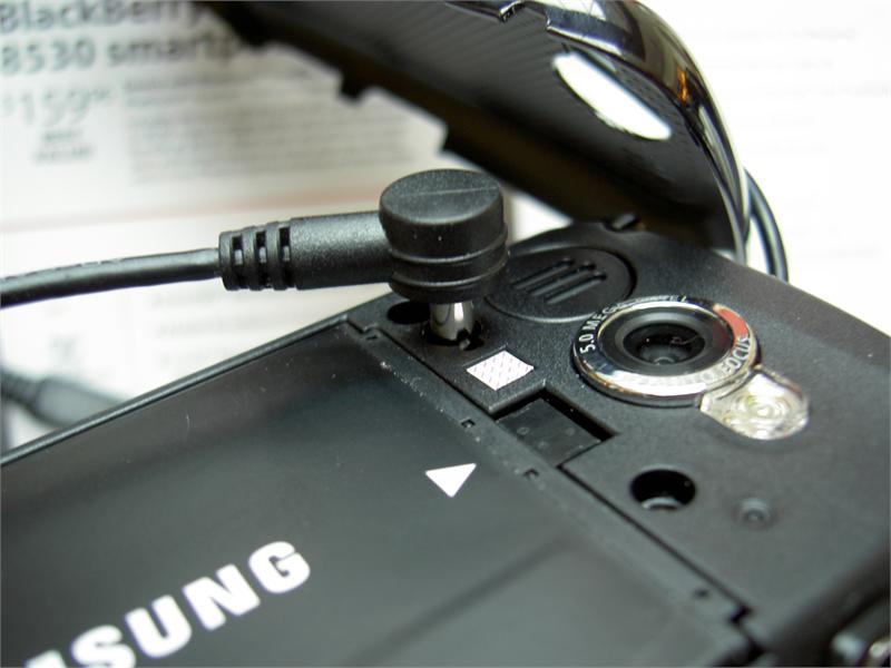

Guest abunhyan Posted October 30, 2009 Report Posted October 30, 2009 PAY ATTENTION! The diagram in the Manual points to a location for soft reset and instruct the user to use a toothpick to press that small slot. But the phone does not reset if you do that. Because that is the antenna slot and the phone can get damaged if someone follow the instruction in the manual..( Page 24 ). The Reset button is the small golden hole between the SIM card and the MicroSD card. I added this to my FAQ thread long ago but I guess it wasn't enough and still many people ended up damaging their phones... so maybe this new thread could help some new users at least! i never did that but still got no network signal in my Omnia 2 than i guess the problem from some thing else :D

Guest forelli Posted November 5, 2009 Report Posted November 5, 2009 PAY ATTENTION! The diagram in the Manual points to a location for soft reset and instruct the user to use a toothpick to press that small slot. But the phone does not reset if you do that. Because that is the antenna slot and the phone can get damaged if someone follow the instruction in the manual..( Page 24 ). The Reset button is the small golden hole between the SIM card and the MicroSD card. I added this to my FAQ thread long ago but I guess it wasn't enough and still many people ended up damaging their phones... so maybe this new thread could help some new users at least! Picture (by monyozt) of the CORRECT Soft Reset button Thanks my friend, but for me it's too late: I'm hanging around with a Blackberry Bold :P , waiting for my Omnia 2 to come back from repair, most likely on tuesday or wednesday :D : 2 damn weeks without my phone! Samsung, what's wrong with you guys? Don't you check your manuals before printing??? WTF? If it was not enough, I still haven't a 6.5.1 rom to flash the Omnia 2 with, what a pain! Thinking more and more of a HD2, I heard of a stylus working on a capacitive screen, created by... HTC. This is great news!

Guest bobhero Posted December 15, 2010 Report Posted December 15, 2010 This antenna connector in question, does anyone know for sure what it is for? Is it for the Cell phone radio? Wifi? GPS?
Guest R3my Posted December 17, 2010 Report Posted December 17, 2010 This antenna connector in question, does anyone know for sure what it is for? Is it for the Cell phone radio? Wifi? GPS? I have the same question. Is anyoane who knows what that connector is for??? Antenna for GSM/ WCDMA it's hidden for our eyes, but I guess that connector is linked with the microstrip phone antenna (for a better gain).
Guest bobhero Posted December 31, 2010 Report Posted December 31, 2010 (edited) I have the same question. Is anyoane who knows what that connector is for??? Antenna for GSM/ WCDMA it's hidden for our eyes, but I guess that connector is linked with the microstrip phone antenna (for a better gain). I think it is for cell phone signal i920 pictured here: Product: http://www.wpsantennas.com/359919-antenna-...i-sch-i920.aspx and here is a much cheaper version with free shipping which I think will also work: http://www.dealextreme.com/details.dx/sku.26405 If anyone tries these please post your results! Edited December 31, 2010 by bobhero
