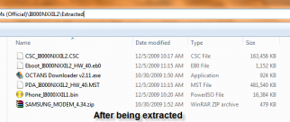

You need to download the whole "I8000NXXIL2" ROM, posted by Secany! If you do so, you'll get somethings like first screen-shot, then after unpacking them, they gonna look like the second screen-shot that I have attached to this post.
Also you don't need any sort of ISO manager, just use "Octan" which comes with Secany's ROM packages AND if this is going to be your first attempt to flash your expensive toy, take a good look at guidelines and FAQ threads in i8000-forum which also can be found in the very first page of Secany's i8000-ROMs thread
