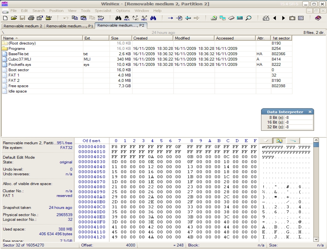

Guest pad4651 Posted December 21, 2009 Report Posted December 21, 2009 i know this is my first post and may sound really stupid but, is it possible that all the i8000's are 8gb and just partitioned diffrent? i was just copying the Cubic37.MLI and i noticed the free space is 7.3gb, my i8000 is the 2gb version. so just thought i'd throw it out there, is this free space partitionable?

Guest pad4651 Posted December 21, 2009 Report Posted December 21, 2009 (edited) @Ender Psp: i've connected though mystorage, and taken alook through winhex. but if i look in explorer it will show 2gb & @iWiNMo: i've not paid a penny for the phone its on contract ;) Edited December 21, 2009 by pad4651
Guest carreab Posted December 21, 2009 Report Posted December 21, 2009 i know this is my first post and may sound really stupid but, is it possible that all the i8000's are 8gb and just partitioned diffrent? i was just copying the Cubic37.MLI and i noticed the free space is 7.3gb, my i8000 is the 2gb version. so just thought i'd throw it out there, is this free space partitionable? I just cheked mine and have the same as you (lucky ha ;) ) actualy its 2GO but with WINHEX shows a partition of 7Go, the same as your picture. but wonder if we can do something to get it in use ;) . I think we need an expert here to enable the 7Go (if there is a chance to). thanks

Guest Ender Psp Posted January 5, 2010 Report Posted January 5, 2010 UK SIM free version was released in October with only 2GB. I would find it hard to believe that they whould basically hide 6GB. They don't. The 2 GB model is actually 2GB. Period. The removable MyStorage media is 2GB, which holds a partition of 1.4 GB with data for the user and a second partition of 512 MB that holds the stock rom. The way WinHex interprets data for the hidden partition is misleading, that partition is stored in 512 MB and no matter what WinHex says it physically occupies 512 MB. What I suspect happened is that 2 GB Omnia 2 models might have been put in production with a previous version of the ROM, the one that includes the "backup" firmware, more like a "final test before release" rather than the final one. What's the point of announcing 2GB MyStorage if you actually have only 1.5 GB free for the user?
