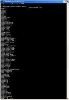

Yeah, i tried a few commands - but for the most i've no idea what they stand for. Attached you can find all possible commands. Maybe you see the one i need :-)
Guest Michael S
When you run "fastboot oem boot", what is the output you see then? E.g. is the sdcard still disabled? If not, make sure that you ran "fastboot oem enableqxdm 0".
So, from all these options, I would recommend to try out these (but without any warranty, so maybe google them before you try):
- fastboot oem enableqxdm
- fastboot oem eraseconfig
- fastboot oem erase (hmm, seems like this would require an additional argument)
- fastboot oem reset
